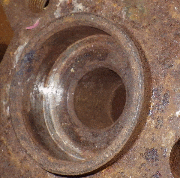

there is a hole there already for the front of the torque converter to go in. I think it needs to be deeper for the A833 input shaft. I didn't measure it when I put it in last time, but I doubt its been drilled to the correct depth for 4 speed.

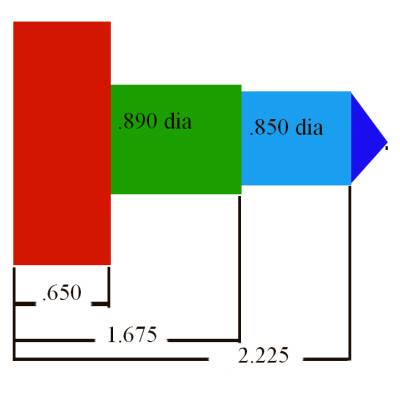

These are approximate dimensions of this steel crank I have "not" drilled for the bushing.
The depth is already there on it. The trans input shaft diameter is .750" I believe. The bushing press fit diameter (green) is not to size and would need to be opened up.....
