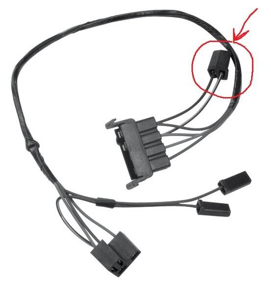

This is the harness under the hood. Follow it from the motor to the bulkhead and see if there is a two wire connector hanging off of it. That connector is for your back up light harness from the transmission to plug into. If you do not have it the 3 wires from the automatic transmission plugged directly into the bulkhead connector.
If you don't hape wiper motor harness down the hood you can check bulkhead conector down the dash. If it got two white wires ( one of the with a black trace ) arriving to the wiper harness block of wires, you need a late harness.
Here is a 2 speed harness with the connector circled. 3 speed is basically the same. This is the later version.
