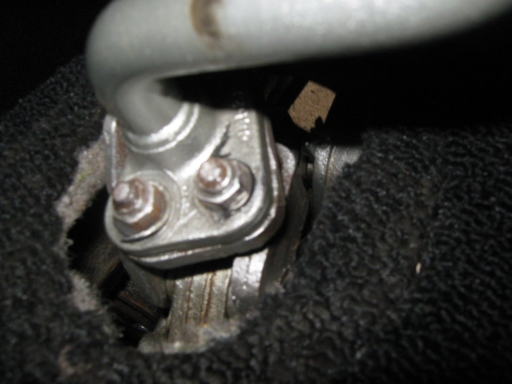

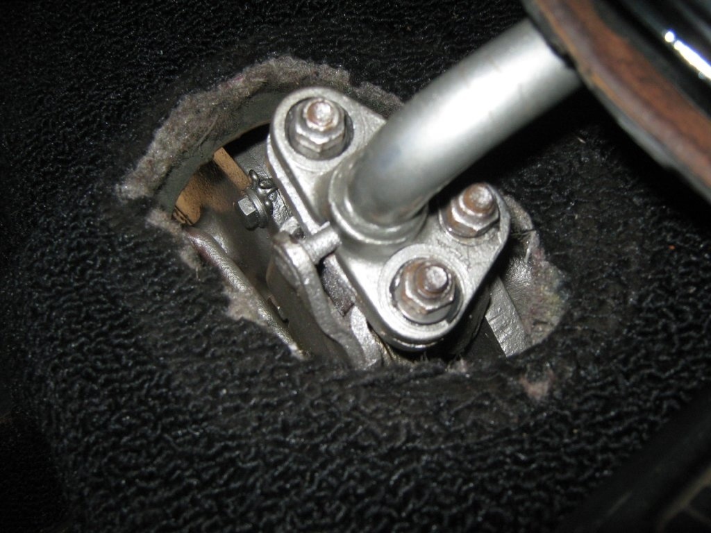

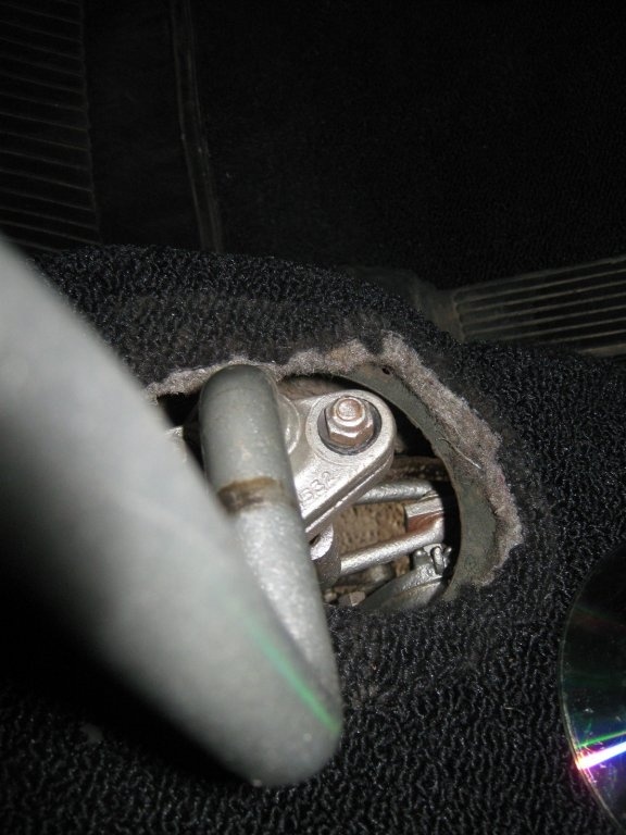

can one of you guys tell me what type of shifter this is its in my 68 b body .. its sloppy in every gear and I guess I need to order one .. they're talking about push in or bolt in .. don't know what push in is ..is this it

I think that's an Inland shifter. A hurst shifter is much better, IMO
I have Inlands in both my Chargers, works fine with no issues
So, what is actually "sloppy"? The shifter arm itself where it bolts to the shifter linkage? There is supposed to be quite a bit of play there. My Hurst pistol grip wiggles probably 2" in any direction in any gear. The shifter arm is a solid bar, so that ain't got too much slop in it. I like my Hurst and all, but if it were my '68, I'd stick with the Inland shifter since it came that way. Now, if the slop is in the shifter linkage, then maybe these other guys here are right. I think the '69 cars had Hurst linkages with Inland shifters & that would be a piece of cake swap. I don't know much about Inland shifters, but are those three nuts tight? Is there some kind of rubber biscuit or something below those nuts that could wear out? Is there a way for you to add a couple washers or something simple to the connection between the shifter & the linkage to take out some of the slop? Just thinkin'.....

No its like a row boat ... have a difficult time finding a gear.. bolts are tight ..you can see the slop is in the plates below the lever ..it moves a good 4 inches while in gear

The shifter mech itself is sloppy. Inland mechanism do not have spring washers in between shift arms and body like Hurst does. It plays a lot and they make the body difficult to service.
