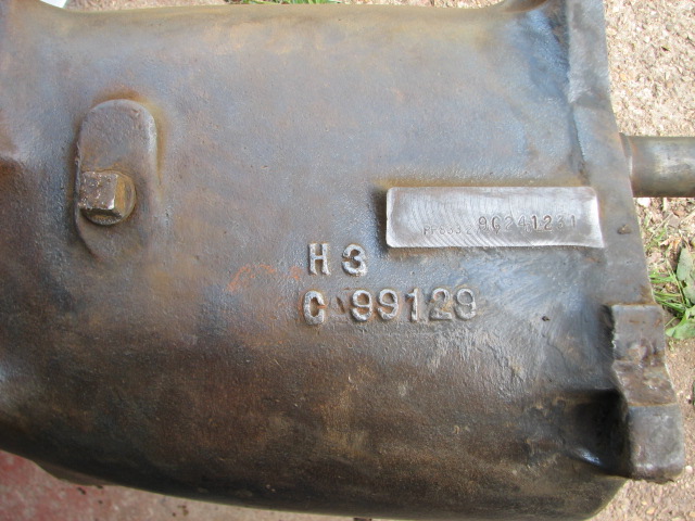

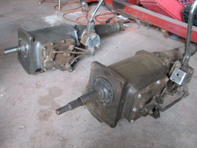

A friend has these 2 trans and is trying to sell them to me. I'm assuming they are out of 1969 year B-bodies due to the casting dates and partial vin stamped into them. Is this correct?
One had the shifter hung up and they took the side cover off and put it back with some incorrect bolts. It shifts ok now.
I have pics of the casting #s I can post if needed. You can still see some numbers painted on them in yellow paint too.
So, what do you think they are worth?

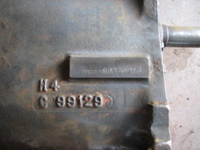

FWIW....If both are 603 transmissions they are out of Belvedere based car (Satellite/Sport Satellite/RR)
definetly early b body.
say they be needy for a rebuild, unsure of price, looks like 23 splines?
not exaclty sure on price, how much you want for 1?
$250 is a deal, $400 if it's close to home and you are afraid to deal with a friend and $600 if you need to get the thing going right now. All used trans are cores without a rebuild receipt to back it up. With shifter add $150 if complete and correct. Il prices. My 2 cents.......

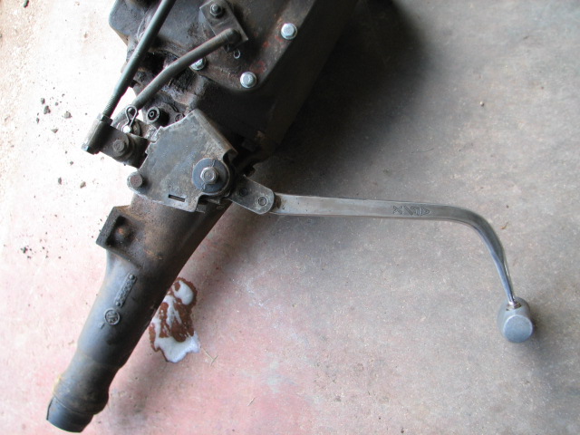

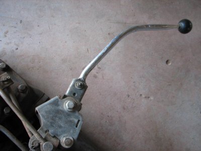

Both have shifters, the one with the Hurst handle looks original to me, but my memory isn't what it used to be... The one with the AFX handle has Hurst stamped into the base also, I think. Somehow I didn't get a closeup of that one.
My friend claimed one of them came out of a '69 Road Runner but didn't know what the other one came out of. They came from an old salvage yard that was crushing out some time ago.
Yes, both are 603 and both are 23 spline.
