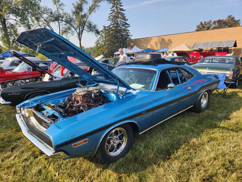

I have Strange Engineering 4 wheel disc brakes with a Wilwood master still using 15" wheel on my street/strip Challenger.
Nice! What brand or brands did you use?
