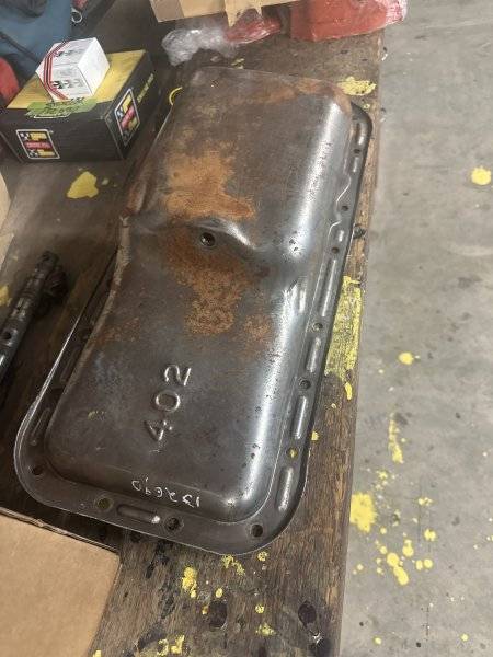

Anyone know if they make this pan close to oem? I see a lot of them looking the same but seems as the specs are a little differently .
Thoughts? 1969 charger 440.
Thanks!!
It doesn't take much of a K-frame trim to fit some of the aftermarket pans. Many times just the RF inner corner of the flange. Of course you can cut quite a bit if you want great access.
Doug
I bought mine from Mancini Racing. They had a deal on a pan and pickup package at the time.
