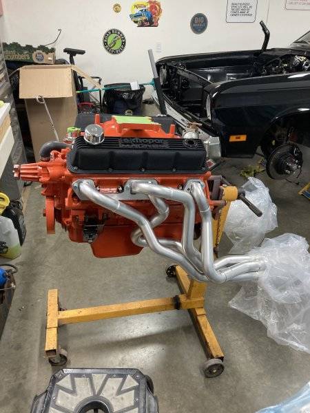

Good Morning everyone,
I am building a 408 Stroker to drop in my 1962 Dodge 440. It’s a 1994 5.9 Magnum block. I know the 318 that was in it originally had a center sump oil pan. I have read where with the increased stroke, it can cause significant power losses using a stoke pan which causes windage issues using a stock oil pan.
My question is: Does anyone have a recommended part number for an oil pan that fits the 5.9 Magnum block, that will clear the increased crank stroke at 408cid and controls windage? Are there scrapers available that will work? Are there windage trays that will work? Or should I just get a deeper oil pan?
Also, I am ordering a Melling M72HV oil pump. Which pickup tubes will work with the recommended oil pan? I have read where I should look for a pickup tube that is larger in diameter than the stock version.

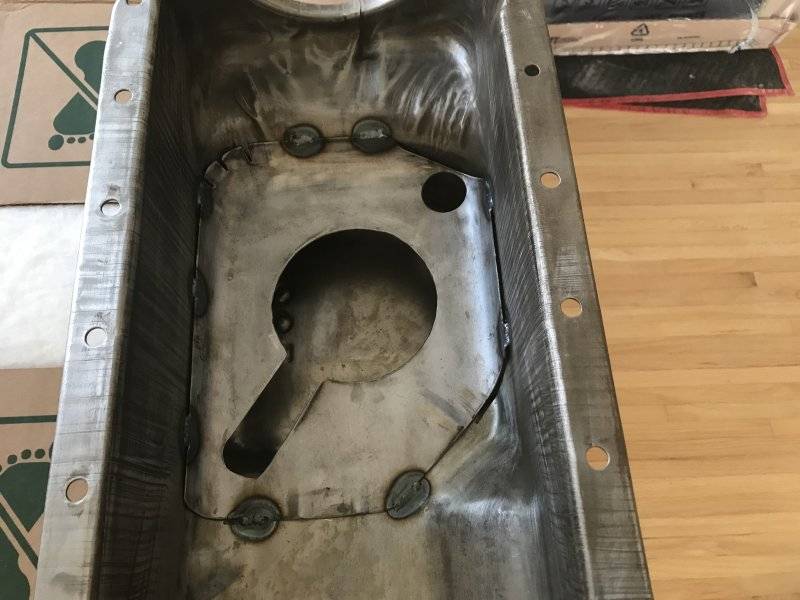

I have a 4"stroke crank in a magnum 360 motor making 402 cubic inch with a stock 360 Center sump pan and don’t have issues with windage or oil pressure flutter or anything really. You may be over thinking it. Your increase in stroke is less than a 1/4 inch each direction.
Do a test fit of the pan with your oil pump installed to see if the oil pump clears the pan. HV pumps will usually be taller.

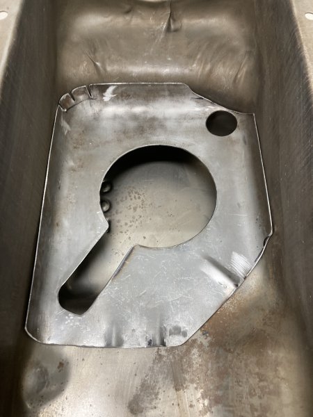

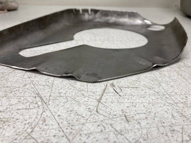

I did make a baffle for the pan while I had it off so it would keep the oil in the sump under acceleration, cornering and braking which I will recommend you do as well, especially when using a high volume pump and stock pan.
