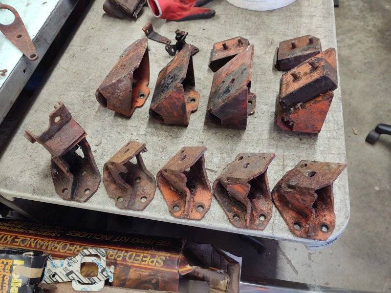

Bought a pile of hemi stuff yesterday and trying to figure out what years these engine mounts fit...any help is appreciated!
Of course the bigger ones are passenger side and the smaller ones are drivers side. I wish I could say what years but I sure don't want to steer you wrong. The drivers side ones that are "torch modified" aren't junk. You have to do a lot of modifying to them to fit a dual line Milodon oil system. Sorry I wasn't more help.
"Early" passenger side mounts are much narrower than say an E body.
Only the rubber part has dots on it indicate the year steel parts do not.
The insulator mount on 70/71 I think don't have the bolt that's on top. Second picture far left is a 66/69 the on top missing on later mounts. The piece almost out of picture is to drop engine in to place, some cars have them some don't.
E & b are different I will try to take pictures of both of them side by side tomorrow
