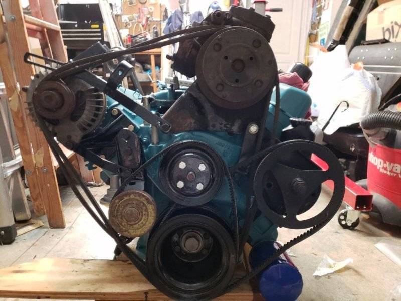

Can someone point me to a source with a 440 engine belt diagram or picture? It is for my 68 Charger. Thx

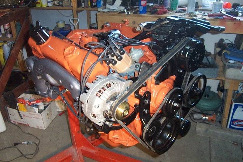

For an AC, power steering car it goes
1st crank pulley grove Water pump, tensioner
2nd power steering
3rd and 4th AC and alternator

The Dodge service manual for 1968 will have what you need, towards the end of the cooling section.
