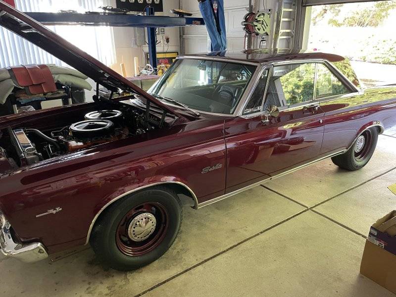

.30 over 440 with cross-ram has never run cool—had a BeCool radiator with twin electric fans—ran 190-195 on a cool day. Hit 205 and more on a hot day accompanied by vapor lock. Last ditch effort was to order a radiator from Bob at Glen-Ray. What a major difference. 88 degrees and humid today, went out for 30 minutes—ran 175-180 all the way—let it idle in my garage for a few minutes and it went up to 190. I’M A HAPPY MAN! THANKS BOB.
