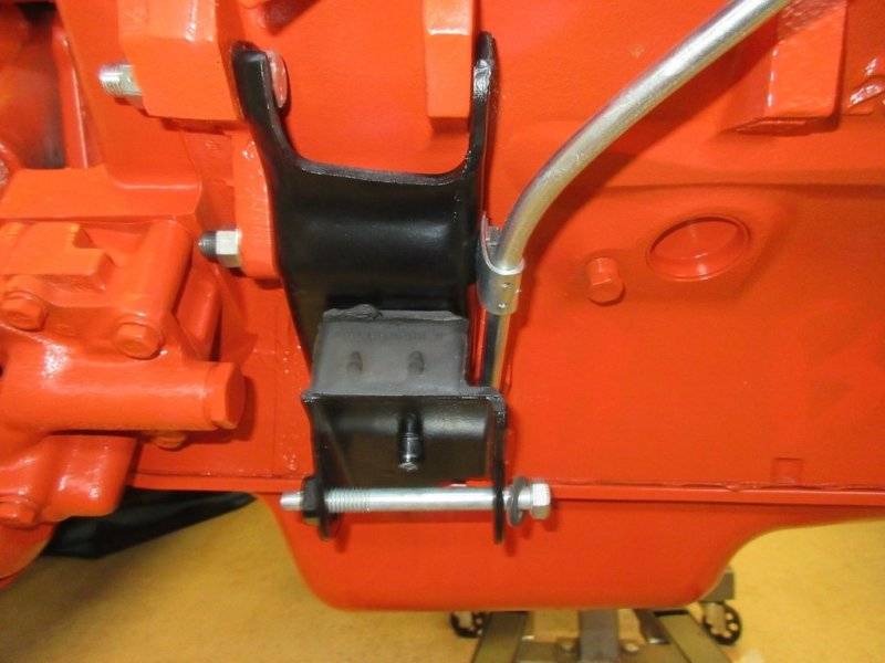

My 68 engine has it's dipstick pressed into a fit without threads in it. The tube has a step in it to prevent it from going in too far.

My 68 engine has it's dipstick pressed into a fit without threads in it. The tube has a step in it to prevent it from going in too far.View attachment 1712143
Yea. The tube I have has a step or shoulder on it to stop it but it won’t go into the threaded hole. Guess I’ll have so sand it down.
