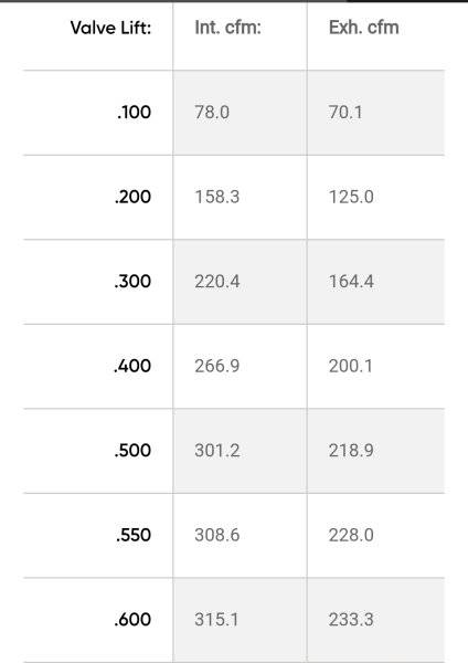

How much are you leaving on the table by going stealth CNC vs TFS?
This is the flow my Stealth heads have. I bought the stock heads and had Muscle Motors do the CNC on them based on their "Mopar for the Masses" article. I purchased the heads before 440 Source offered a CNC head. I'm sure their process is close to this.
