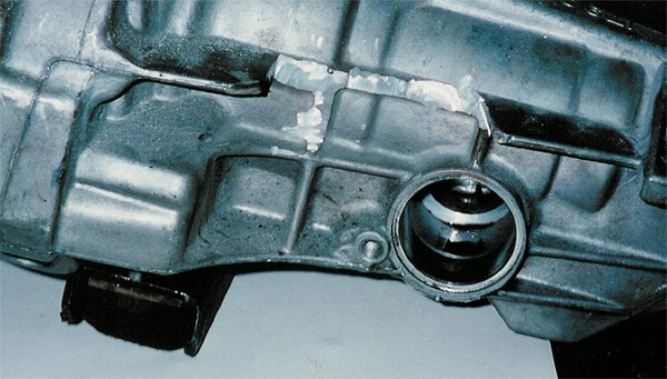

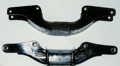

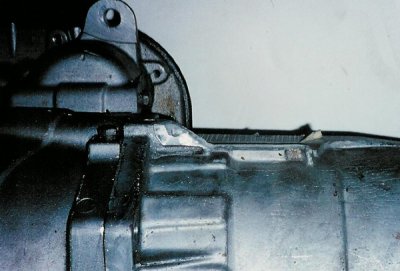

not too many modifications required.. see pictures below on how you can modify the case and not the tunnel so it can fit.
