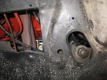

Its been a few years since i messed with mine. Iirc you get to the nut to tighten in through the left wheel well. There was a slot in the frame for it.

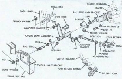

Isn't this a diagram for a body? My frame rail doesn't look like that.

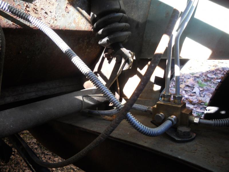

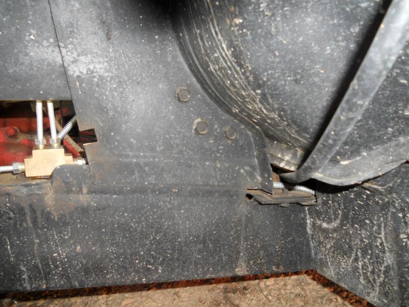

Here are pix form my '62. The ball mount bracket is the piece with the curled edge almost hidden behind the end of the z-bar; it is orieneted so the ball is to the bottom and front. The 2nd pix shows the bolts from the wheel well side of the chassis; they are self tappers that go into tacked nuts or holes on the ball mount plate; you can see the end of the bolts sticking through on the 1st pix above and behind the z-bar lever arm.
Thanks you very much! thats exactly what I needed! Makes perfect sence now that I see it!!
