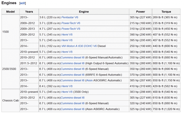

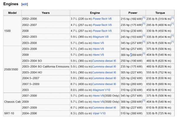

Is yours a Ram 1500 or 2500? Not that Wikipedia is the end all of information, but I was looking at the following charts:
THIRD-GEN RAM (2002 - 2008)
FOURTH-GEN RAM (2009- PRESENT)

There is a definite difference between those two engines.
