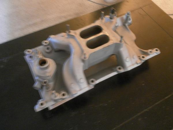

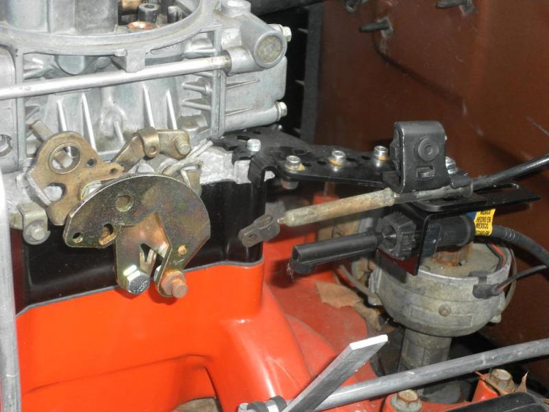

Use the Professional Products Crosswinds intake. All your A/C & everything will bolt up perfect Hughes engines has the cam extension to use your original fuel pump & Bouchillion has the throttle cable bracket & kickdown cable kit for your trans even allows me to use my cruise cable too
