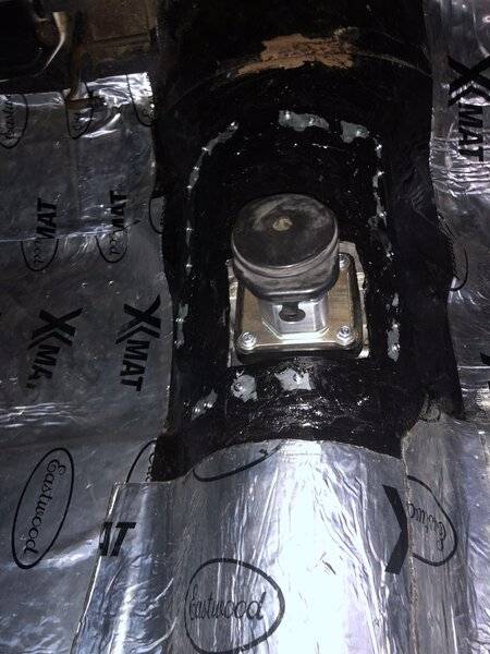

I just did the TKX in a B body. The picture below would be the only hole required. I was originally getting a TKO so I had already cut the larger opening. The TKX fits tight without mods. One spot in the drivers tunnel will need a “universal wrench” tap for a small horn corner of the TKX.
thanks for the responses. Yea, I will go with the 5 speed. I was under the impression that no cutting was needed with the 5...oh well, no biggie
