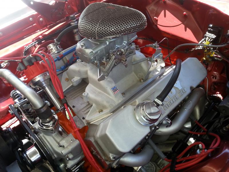

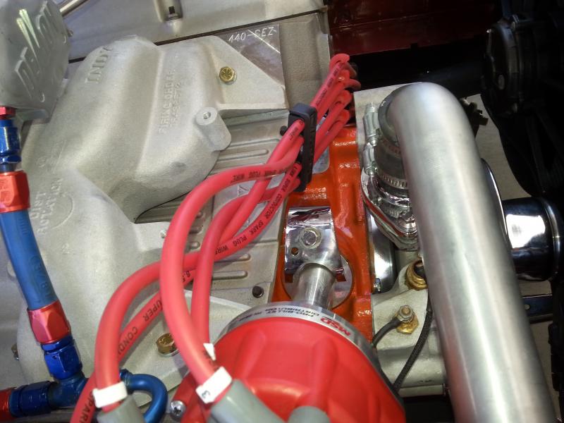

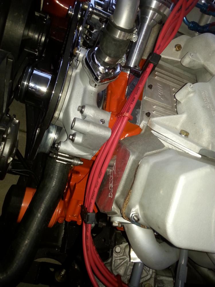

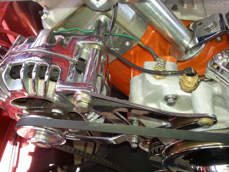

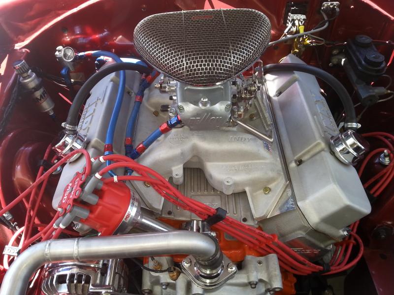

Got the new 505" into the car a couple days ago. Wanted to share some pictures. 526.jpg528.jpg529.jpg531.jpg535.jpgScan0005.jpg

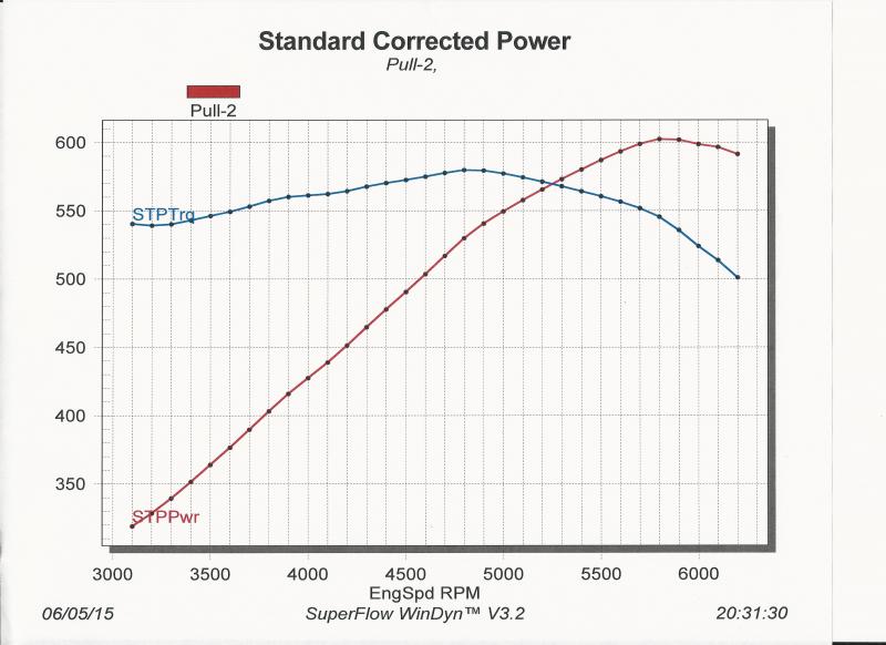

Also attached is the Dyno Sheet Print Out.
540LBS of Torque @ 3100RPM and 602HP @ 5800RPM.
Hoping for 10.50 to 10.80's @ 123 to 128....I have no idea what it will do but I can't do anything else to the car to make it perform any better and still keep in 100% street legal and street driveable.
Every thing is brand new....505"/Comp Solid Lifter Cam (and complete Comp Valve Train)/440 Source Roller Rockers/INDY Dual Plane Intake (Non-Max Wedge Ports)/ INDY SEZ Heads (Non-Max Wedge Ports)/850 Mighty Demon Carb/MSD Pro-Billet Dist and 8.5 MSD Wires/Ohio Crankshaft Stroker Crank/Ohio Crankshaft H Beam Forged Rods/SPE 12.1 CR Forged Pistons/Hooker Super Competition Headers/B&M 8 Bolt Hemi Pattern Flex Plate w/1/2 Bolts/Moroso 7 Quart Pan/Mildon PickUp/Aluminum Housing Water Pump/5200 Flash Converter (by Lenny @ Ultimate Converter in North Carolina)/ Torqueflite with all the heavy duty Sprags, etc/4.10 Detroit Locker/Moser Axles/28x13.50x15 MT ET DOT slicks/Moroso DS2 front tires) Weld 15x10's and 15x4's/ Disc Fronts/Drum Rears/Cal Trac Bars and MonoLeaf Rear Springs with Cal Trac 9 way Adj RR Shocks and Cal Trac 90/10 Frt Shocks/Fiberglass Hood,Front Fenders and Frt/RR Fiberglass Bumpers/ 10 Gallon Fuel Cell with 140 GPM Mallory Pump....etc, etc.

That looks great ! You did a great job putting the eng in it. You know you may go faster then you think. I have run 10.70's and your build is stronger then mine and I run a full exh system on the car when I race and I only have 10.6 comp. So if its a race only car you will run open headers and you do have 12.1 comp also. You could be pushing the bottom half of the 10's if all goes well. I cant wait to hear how she runs for you. I wish you "Good Luck" on its first outing as we all know the little quirks that like to pop up on us. Ron

Looks great a nice clean installation.
One thing I noticed is the fuel regulator on the firewall?
That needs to be mounted at least 6 inches forward of the firewall/bellhousing area as per the NHRA rulebook.

Thanks for the info....before I run my next NHRA race event I will relocate it.
