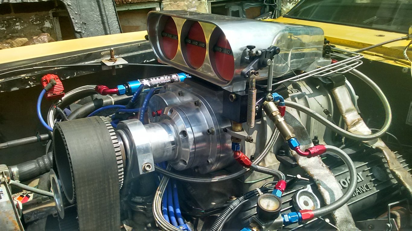

hello Bryan,
Got to just love a 512ci engine its a perfect street/stripper!
We have one in a 66 Polara at the moment down in London Town UK.
Edelbrock heads and a Crower street roller 0.550 camshaft.
My mate in Sutton has just had his identical 512 built too.
Thats in a street/strip barracuda so an easy ten second car I bet?
This 512 ran 13.20 in drive at shakey the last meet ever, so sad...:fool:
