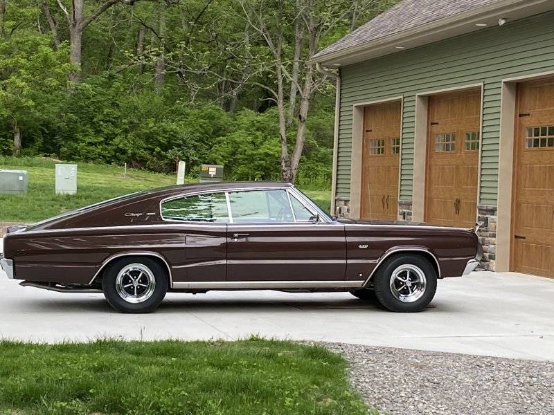

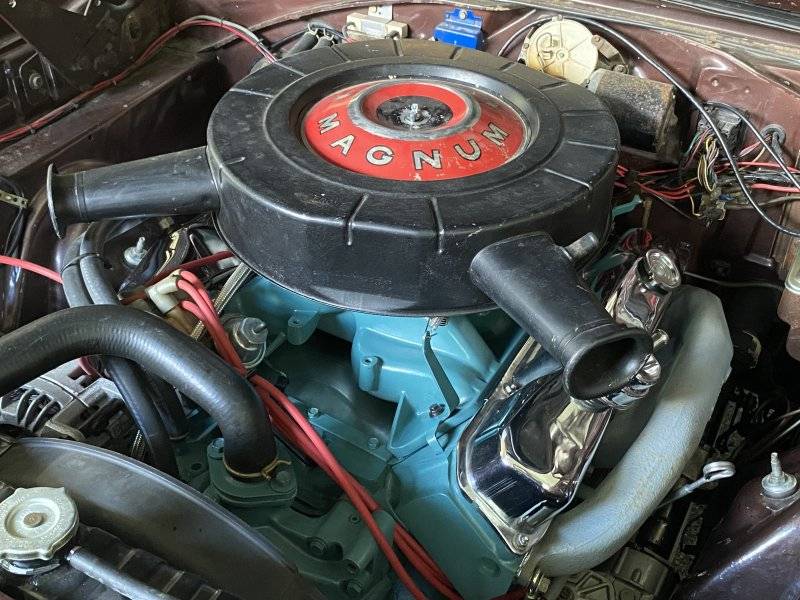

You’ve probably seen this before but here it is again:
This motor:
In this car:
At 4150lbs, 3.23 gear, 1700 rpm converter runs 11.70s at 120+mph. Idles with 15” hg, and drives through the neighborhood in 3rd gear at 1100-1200 rpm.
Obviously nothing is stock. Indy dual plane intake and a “950” Holley.
My motor in the OPs car would probably run 11.20 @ 125 mph

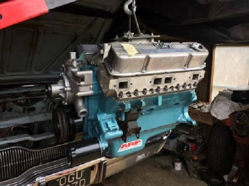

hello Bryan,
Got to just love a 512ci engine its a perfect street/stripper!
We have one in a 66 Polara at the moment down in London Town UK.
Edelbrock heads and a Crower street roller 0.550 camshaft.
My mate in Sutton has just had his identical 512 built too.
Thats in a street/strip barracuda so an easy ten second car I bet?
This 512 ran 13.20 in drive at shakey the last meet ever, so sad...:fool:
