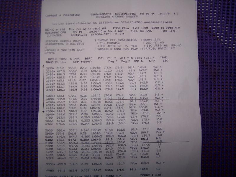

A number of months ago I wrote to over a dozen engine builders around the country or, maybe I should say within a days drive of where I live, to submit bids for a 500ci+ stroker motor (didn't care if it was a B or RB). However my request was a little different from the normal requests that these builders get, at least that's want many said, as I specified a list of performance specifications rather than parts specifications and/or brands.
Basically what I was wanting was a street motor with lots of low end grunt, decent manners and low maintenance. More specifically I wanted a 500+ci, capable of producing 600tq at 3200rpm and holding it for a minimum of 1000rpm. Maximum hp had to be developed inside of 5500rpm with a minimum of 1hp per ci. Motor should be able to rev safely to 6000rpm. I consider these attributes to define what I term as a low RPM motor. The only boundaries I set were a minimum of 10" of vacuum, hydraulic lifters, maximum converter needed at 3000, B body oil pan, straight spark plug angle, maximum 93 octane, aluminum heads and if possible a dual plane manifold. Motor had to be complete including carburetor , distributor and waterpump. Dyno and tuning must use my components in effect saving me the cost of having to tune the motor and knowing exactly what the HP and TQ the motor would generate as well as making it a plug and play install. Then the big caveat, which caused 70% of the builders to bale, build the motor $8,500, which includes the block!

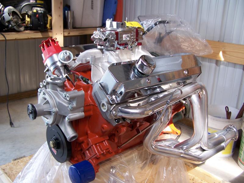

I visited CME this past Thursday were Richie, the sales manager gave me a tour of their facilities then introduce me to Bill, the man who assembled my 526ci RB engine and his brother John, who operates the dyno and does the tuning. After spending 1 1/2 hours at CME there is no question in my mind that I chose the right builder. I have no doubt that there are other good builders out there but CME met and exceeded all my performance specifications and miscellaneous criteria for just a tick over 8.3K.
I did however make a poor decision, at least in my mind, concerning some CNC work on the aftermarket heads. CME offers a variety of horsepower on their 522ci motors. Each HP increment reflects either a higher level of performance parts or greater degree of modifications to a part(s). Because I thought that it would be a good selling point to list that my motor had the heads CNC gasket matched and bowls blended, which is one thing that differentiates the 550 hp motor from the 525hp motor I decided to have that milling work done on my 526 (I requested that they build me a 526 verses their normal 522ci). But something unexpected happened and that is the torque fell by about 30fp. Normally their 525 and 550 hp motors put out 650+ foot pounds of torque, however my horse power did increase by 24 for a total of 549hp. Now some guys like to measure engines by hp but because I was wanting a street engine I tend to favor torque output. On the plus side I got the hp of their 550 horse motor but still maintained the vacuum and converter stall that made me choose their 525hp version. Not only did they deliver the 600tq I specified they hit 600tq at 3000rpm and carried it to 4500rpm, a 1500 rpm spread!
One thing I should point out is that CME assigns just one person to assemble the engine from beginning to end and Bill told me that he has built dozens and dozens of these 522s over the years and knows them very well.

Eng looks great ! I am using the same valve covers on my 493. Sounds like you got a nice eng there. Good luck with it. Ron
What kind of headers are you running? Mini-starter? I need to get headers, starter, and a few stand offs for the spark plug wires (advice from anyone?) for my engine.
THese are the Jeg's 1/7/8 ceramic coated which are the hooker 5903 design (Jeg's claims that Hooker does not build them. Summit carries the exact same header for their brand). Mini starter from 440 source which I believe is a Delco. If you are producing over 450hp you should be running 1 7/8" or larger, this according to Doug Thorley specs.

I have the CME 522/525 ended up making 530 peak hp and 660 peak torque.

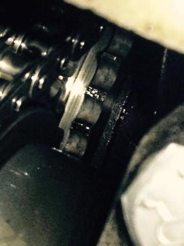

Last year when we did the first oil change we found three chipped teeth in the pan from the timing gear. No rhyme or reason other than maybe a faulty part to begin with but Ritchie immediately boxed up a new timing gear set and sent it out to me. (I'm in Canada so any use of the warranty is really pointless)

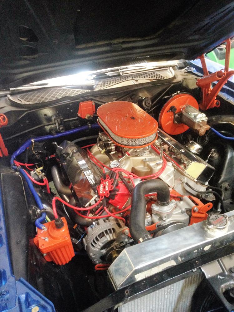

As far as cooling goes I have a Roadrunner so I was limited with the 22" rad. I called Wizard Cooling and told them what I was working with and they put me onto one of their 2 Cores with the upgraded core to 1.25" tubes and the integrated 4 - 9" Spal fans. Works like a charm!
Not sure who your fans are made by but a lot of fan companies have false CFM Claims. Wizard makes an even better 26" than my 22" so if that is an option you would consider exploring I would say it's worth it.

I moved to a 3 core aluminum radiator and 2 17" fans -One Pulling and one Pushing. Fans are mounted on each side of the radiator. Your right these fan manufactures tend to exaggerate their fans performance.

Also, I prefer to be present on dyno day.Makes it harder to fudge the numbers.
