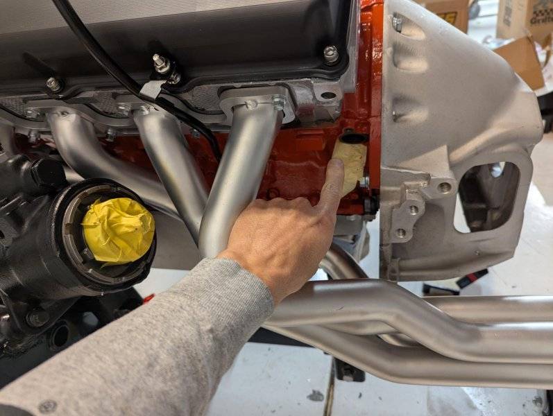

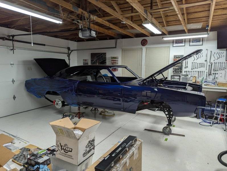

Hey All,
Making some good progress on my '68 Charger Resto Mod. Paint and Body is complete, now putting it all back together.
Specs: 6.1 Liter Gen III Hemi, 2007 block. Tremec TK500 5 speed Transmission (converted over from automatic), 8 3/4" rear end with 3.73 gearing, stock suspension set up with newly manufactured parts by Firm Feel. Power Disc brakes all around.
Got a question: There is an opening on the rear of the driver's side of the 6.1 Liter and I have not been able to (quickly) figure out what sensor this is. If anyone happens to know and (fingers crossed) has a part number that would be amazing. Thank you all!
Pretty sure that's the blockheater sensor.
( block heater)
( block heater)
Sounds logical to me. Nothing was in that location on my 6.1 and it was not used. Nice job on your build by the way. What dip stick are you using? I like that way better than the Bouchillon unit they sent me back in 2014.
Thank you Rem Charger! Looks like you're exactly right...interesting. Found the part here.
Authentic Mopar Engine Block Heater V8 HEMI Engines - 82208937 | Mopar Online Parts
It comes with a standard wall plug....uh...that's a new one for me. Not sure I'd ever actually use this, I'm in CA. and in a place that doesn't get that cold. Not sure I'd ever need this. Interesting.
Thank you again!
Any other input? Am I underestimating the importance of this part?
The block heater is only needed for cold climates, I grew up in ND and every vehicle had one. Vehicles sold in Canada also get them but as you point out you do not need it.

Thank you 70 Chall440! And thank you for the help all along the way - your advice has been invaluable. I'm excited that it's getting to a place where I can see the end of the tunnel. I wonder if there is some type of block off plate I can find...probably can't just leave it open? Or can I....
My 5.7 has the same hole, I just left it open.
