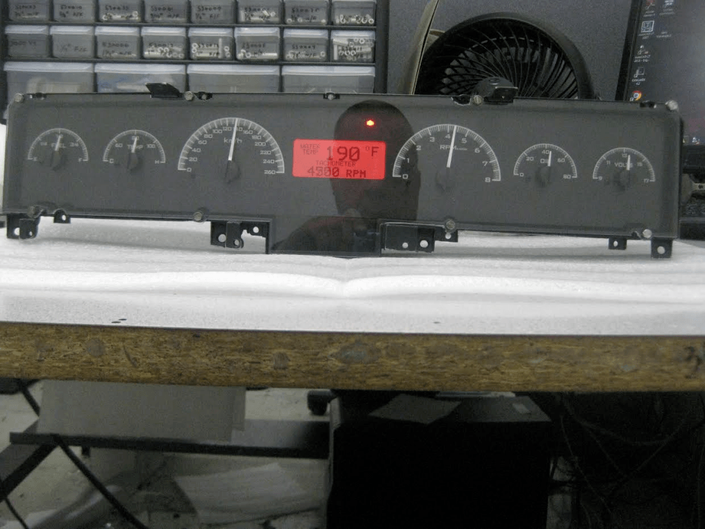

I know you are indicated you were looking at the autometer gauges but have you looked at the Dakota Digital VHX line of gauges? They are a super clean install with just a single cat5 cable going to the back of the cluster and the gauges look mechanical. There is a I/O brainbox that you mount remotely and that is where all of your input wires go to... I have seen them in several retromods and the install looks great, easy, and clean (<- seems like I should make some sort of reference to the women I like, but I wont at this time... gotta stay classy!) I attached a link and I think you can order them through classic industries too....
http://www.dakotadigital.com/index....t_id=939/category_id=679/mode=prod/prd939.htm
Both of the options you showed won't work in a 69 RR ( see the note excludes Satellite models)
I sent my cluster to Dakota digital and they converted It to a custom VHX unit. I also went with the GPS speedo to avoid that headache.
Here's what mine ended up looking like

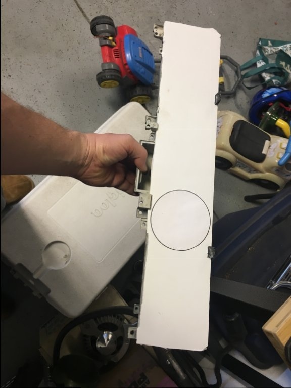

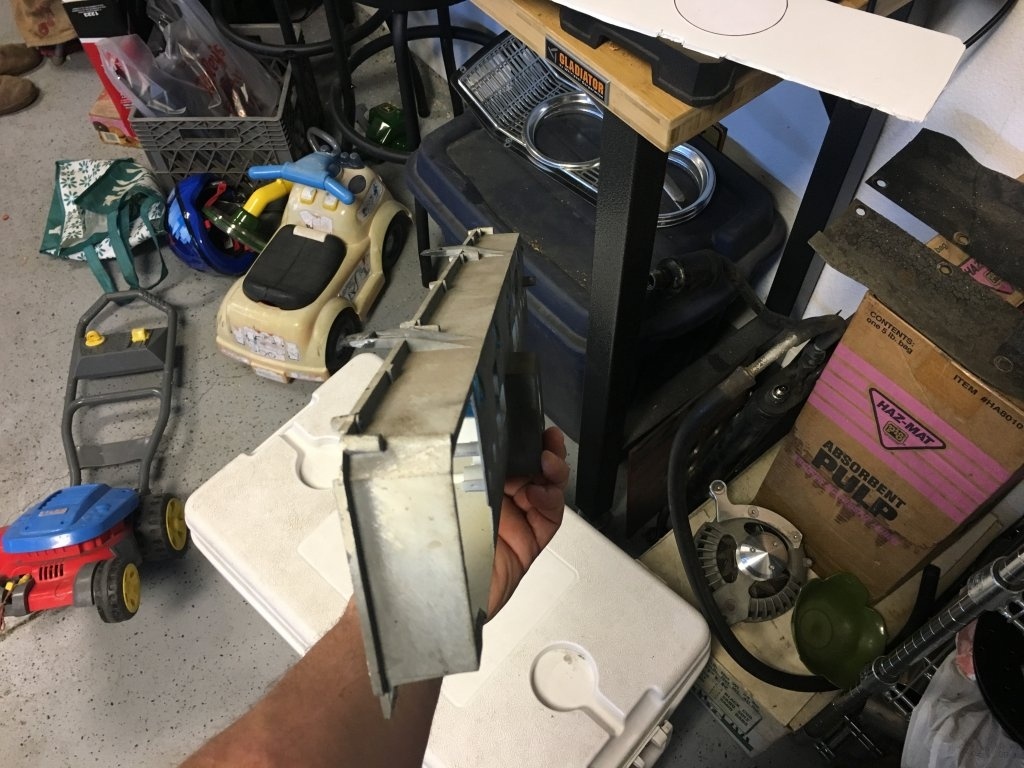

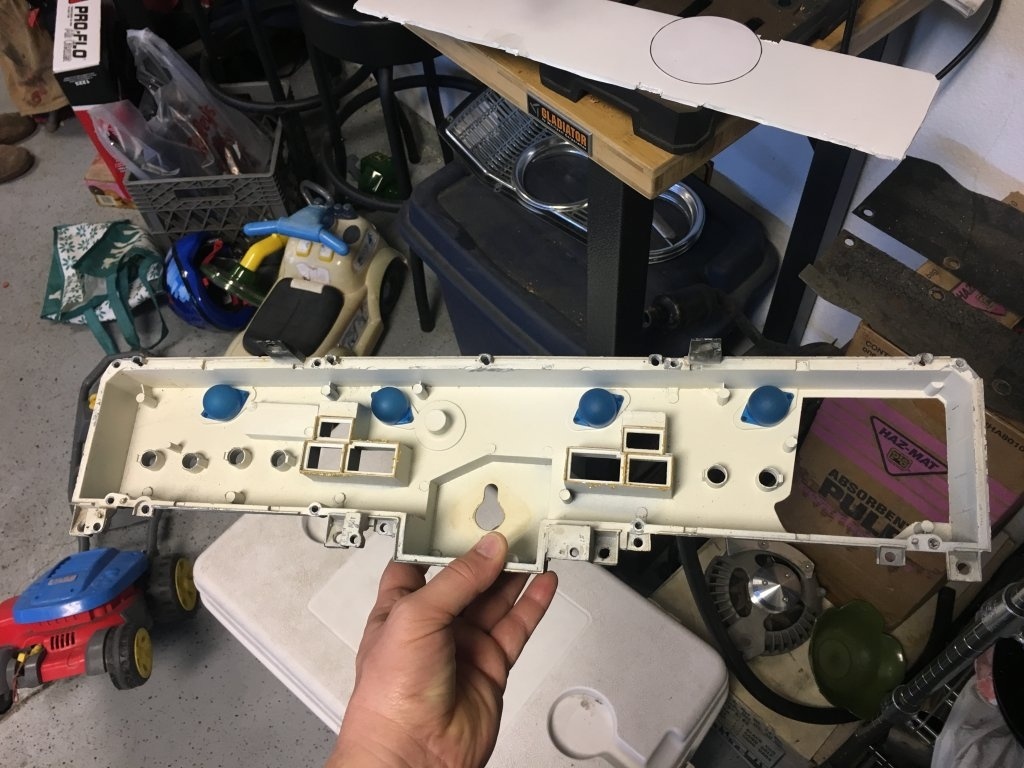

Yea goon is right. Those kits are for rally dashes. You can fit 3 3/8 SpeedHUt gauges with a custom enclosure
Basically use an old speedo housing, which has all the correct mount points then make a plate to go across the front and mount all the gauges to.
Almost stencil out the cluster?.. would that work? 18g steel? I can prob design that on CAD and have it cut.... I like it
I made a template out of some foam board. Yup 18ga or a nice machined piece for finished setup, this is what I have for a rough look. I plan to open up the back for more room for wiring too.

How much did it run for them to convert the cluster? Also.. how long did it take?
The base cost was $1300 and I added extra sensors and a GPS Speedo. I can't remember exactly but I think lead time was about 6 weeks. I sent them 2 cores the other one may still be there
They wanted 24 weeks min and min $1500... I think im going to pass.

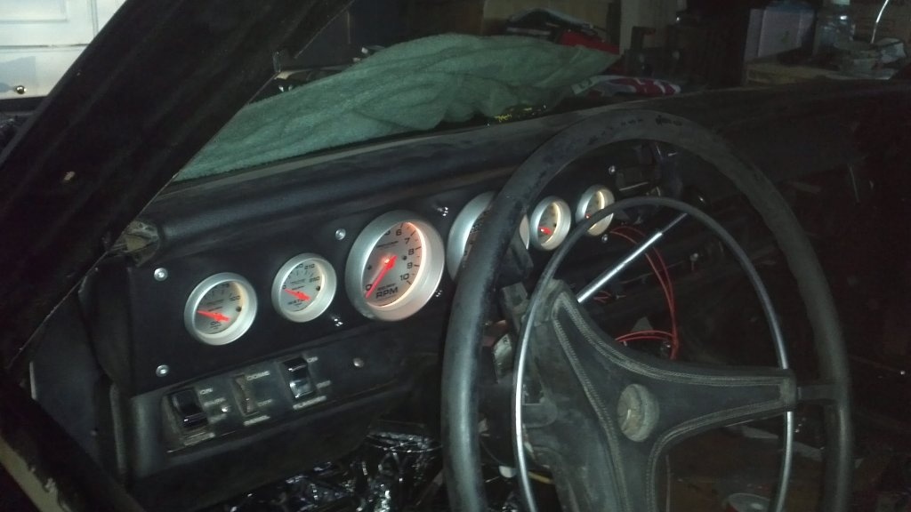

I ended up using a piece of sheetmetal and bent it to fit then wrapped it in vinyl. There's turn signals, highbeam, and oil pressure LEDs around the speedo and tach. The left side had a 90 degree tab to lock it in on that side and the right side is wedged in place so that it can be pushed in to remove. Time to start saving my pennies that Dakota cluster look great.
This is definatly a route i am considering... simple, easy and clean!
I really did not like Dakota's careless attitude.. and 24 weeks.... F- that!
The rivets in the corners are there mainly for aesthetics and to help hold the vinyl in place. This was the first build. If you attempt it the speedo and tach do not tuck in very well so that part of why it sits out. Base the build off those first. I also used the painless gauge wiring harness so that it can be removed if needed.
