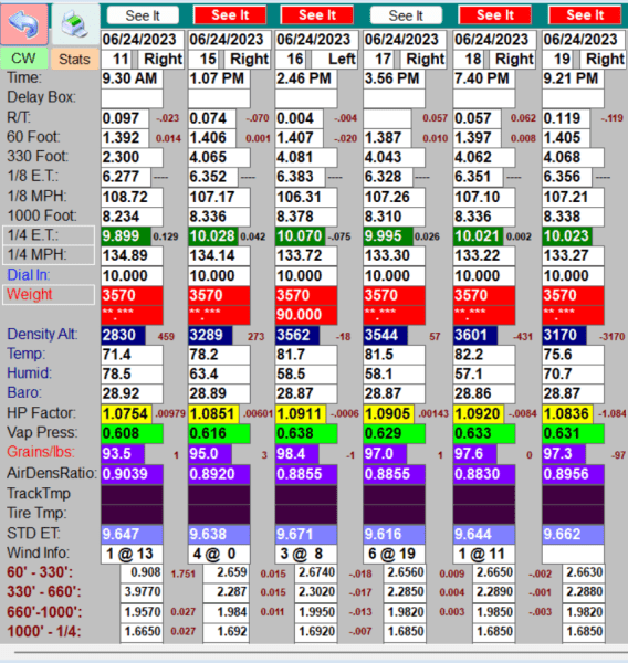

It worked well when it did get down the track. Quick. Will be interesting to see where it ends up with more fine tuning.
Your data sheet is interesting to read and to compare to against my data. Your DA, barometric pressure and comparing how your car changes throughout the day with it. Last weekend our DA was hitting 4600 and barometric was 28.08 on my handheld unit.
Here’s my round 1 last weekend. Can’t get much tighter than this and we both got on the brake crossing the stripe. I’m right lane.
The change in ET vs weather in the instance is misleading. As we adding ballast to run the 10.0 index. It had as much as 175lbs. I haven't figured out why the ballast doesn't always show up in the data on this screen.
Doug
Nice passes...
after all that work to get there :thumbsup:
