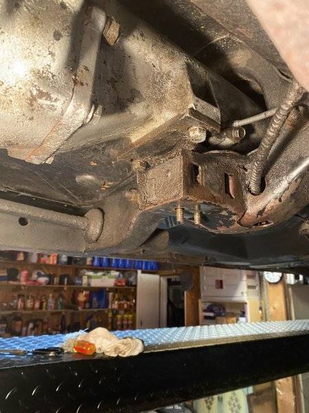

Hi guys, 1962 Belvedere 318, 3 Speed Manual Transmission has leak coming right off bottom of transmission mount. I had speedo cable out recently to lube/put back in and replaced o-ring and it started leaking off transmission mount afterwards… BUT…there’s no apparent leak right above at speedo cable mount/clamp. What else is above/in there that could leak where it flows down inside transmission mount drips out the little holes on the side forming an incessant drop right off the very bottom of mount? I’m ready to pull the transmission mount to see what’s going on. But before I do, any insight?

I just took the nuts off to (possibly) drain it out quicker if that’s the issue here. Oil steadily dripping out of one of them as we speak. Observation: the stamped cutouts on each side of trans. mount were plugged with grease old dirt/too. I cleaned a few of them out…oil flowing out there too. Seems like a few more could be opened up. I sure am hoping you’re right. Should just take mount off and clean it…that would verify. If those side cutouts were closed up with dirt/grease…I could see it holding hold oil in there quite a while…I suppose. Maybe a carefully drilled hole in bottom would let it all out…much quicker.
