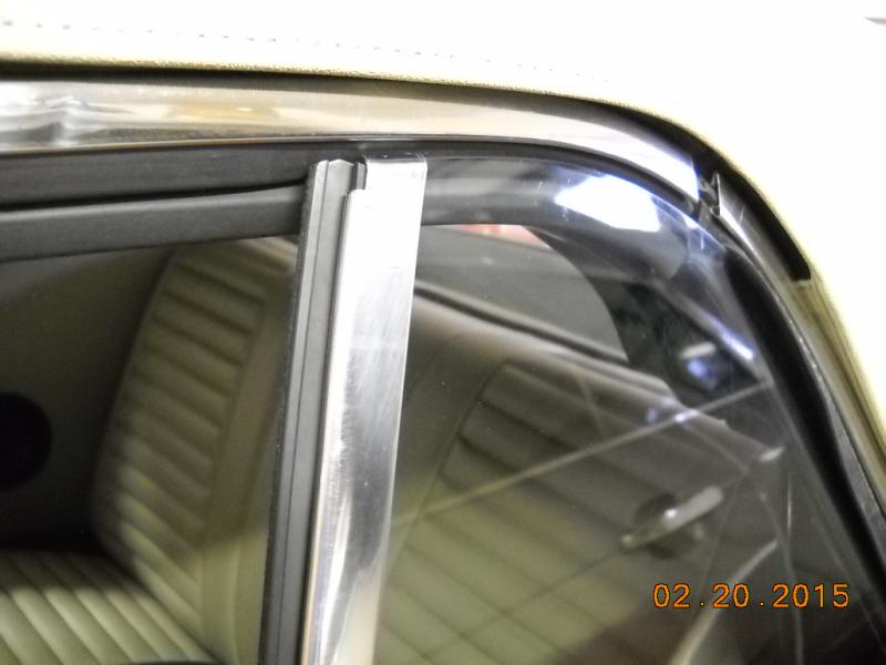

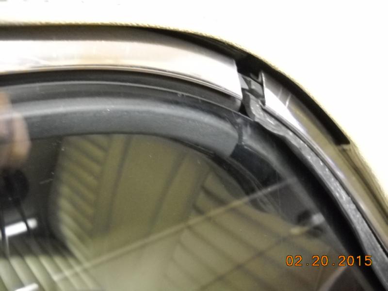

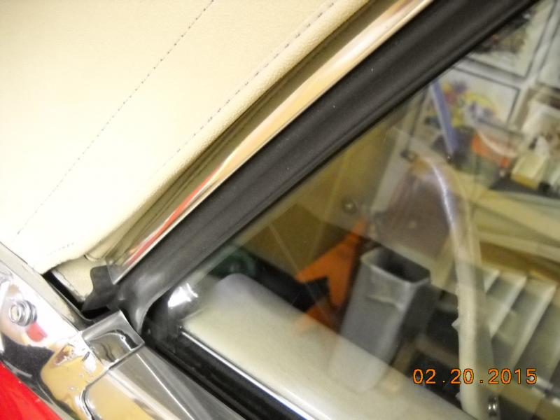

Once again I'm asking for help to provide me with a few pictures of the fitment of the quarter windows to the convertible top weather-stripping.I'd like to see how the window contacts the rubber; outside, inside or in between. Can't find pictures and FSM is no help. Please PM me if you can provide pictures. Need pictures of areas shown below:

But just remembering things...where the two ends of both rubber seals meet, should be in line. There is some kind of super rubber adhesive that's used to glue the mating ends together, once lined up.
In the top photo, for the gap in the stainless trim, thinking there should be one of the slip in connectors, for the trim, to join them, and fill the gap.
