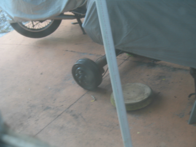

Too bad your on the other west coast... I have a converted rear axle with new bearing and rebuilt brakes with less then 1k on it. open rear unknown gearing. offered it up for beer with no takers.. thought about cutting it up for trophies but couldn't . now its a toe stumper... IMG_0025.JPG

Too bad your on the other west coast... I have a converted rear axle with new bearing and rebuilt brakes with less then 1k on it. open rear unknown gearing. offered it up for beer with no takers.. thought about cutting it up for trophies but couldn't . now its a toe stumper...View attachment 205653
