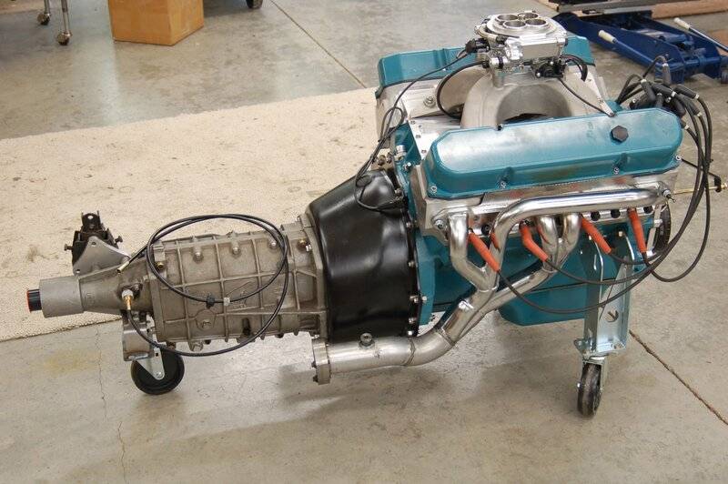

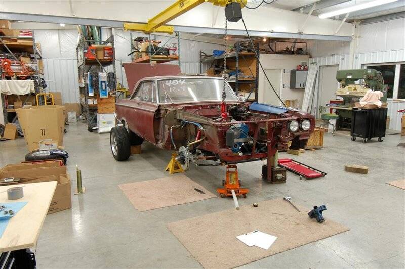

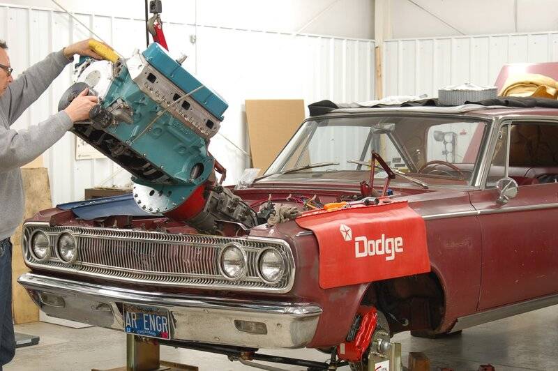

I do it all the time.
I even put the engine and transmission together before it goes back in.
After close to 50 years in the auto repair business I've learned. Many times removing more pieces for access is quicker than doing difficult jobs in a confined space. It would take more time to reinstall than it would save. Either pull the trans 1st. Or remove the engine and trans together.
