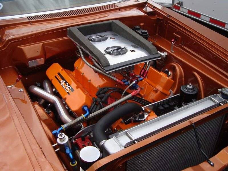

Never done a late swap. But the factory K frame mounts on a 62-65 are 1.5" further ahead than 66-70. I have moved the fire wall back on 62-65. A 2×4 laid across the fire wall. Then a bottle jack with a 4x4 placed between the 2x4 and the K frame. Its amazing how far you can move it. If you go to far it will put a small link in it. Look at this pic. Notice the body line is curved on the firewall behind the right valve cover/intake area. It's back 1.5" easy. Cant remember exactly how far I moved it. But my motor is back and I wanted a cross ram to fit.

DougView attachment 1031252

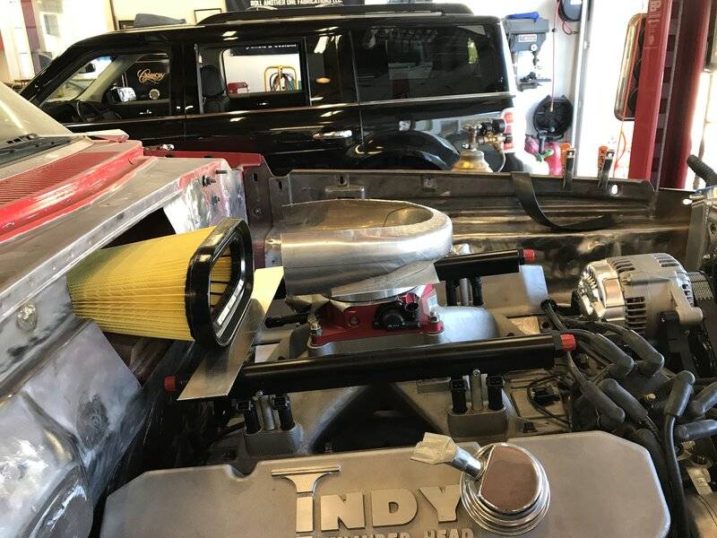

It would save you some aggravation if you jump into the project knowing you will have to do some creative work. If it all falls into place, count your blessings. On my setup since there were so many variables, 70 k-frame/Indy aluminum block/Schumacher spool mount conversion for Hemi style block mounts, I ordered my TTI units[ they make them for that specific engine combo I'm using] uncoated. I figured I would need to do some massaging here and there which did happen. After I get done they will get sent out for coating. I think it would be beneficial to you to do likewise.
