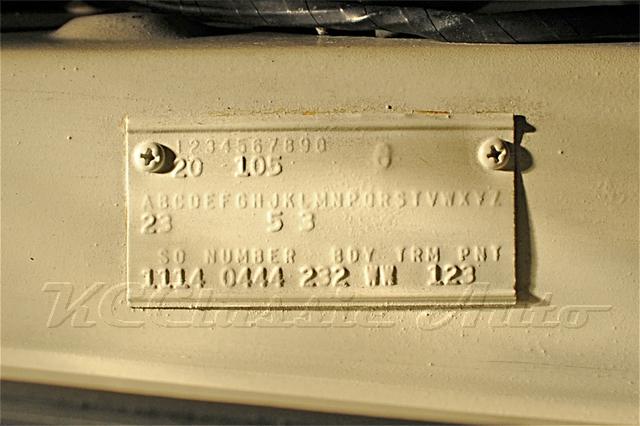

Can someone tell me if this is a two or three tail light order car ?
The seller says it's a Fury..... can you tell me by these #'s what it actually is ?
Here's a stab at the decode, assuming 4th digit of VIN is 1=Lynch Road:
A2 = 225 6cyl
B3 = Torqueflite 6 cyl
J5 = Heater
L3 = Back up lights
1114 = Sched prod date = Nov 14
0444 = Shipping order #
BDY 232 => 2=Plymouth, 3=Fury, 2=1962 (looks like same as 1st 3 digits of VIN
WW = White roof & body
123 => 12=Bench seat, cloth & vinyl, 3=Cordovan (color)
Regarding the three lights vs two, early production may have only received two per side. Sometime later in the year I believe Plymouth added a third light - there was a kit where the dealer could add them as well.
dart1962 is correct on decode L -3 is back up light car.
Main info is 'mid 62 ' ie January -onward, plymouth, and dodge came out with revised trim packages, especially with beltline trim, but also rear lights, ie adding the 3rd taillight for plymouth.
Your November car is 'early'

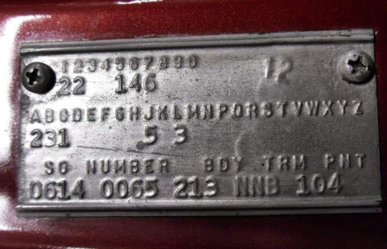

Interesting deciphering work. where did you guys find this stuff? Here's one to think about. This tag is from my 62 Plymouth Savoy..
Much the same translation for options, mine has two tailights, one red and one clear for backup. Note the date info. Going by the analysis done above on the other tag mine had a scheduled date of June 14, was 5th in sequence but on the BDY info 2=Plymouth, 1=Savoy but 3??? 1963?? The color was a turquoise with grey colored vinyl/cloth bench seats but not sure how it decodes from there?
Regarding the Fury, the BDY of 232 appears to be 23=Plymouth Fury and the 2 isn't the model year but related to the body style
On Stumper's car:
A2=225 6cyl
B3=Torqueflite
C1=Economy AM radio
J5=heater
L3=b/u lamps
0614 = sched prod date (June 14)
213=Plym Savoy
NNB= N is Alabaster, K is Turquoise, B is black roof. Is the N a typo or are the books wrong??? not sure...
104=Bench, cloth & vinyl, Gray
