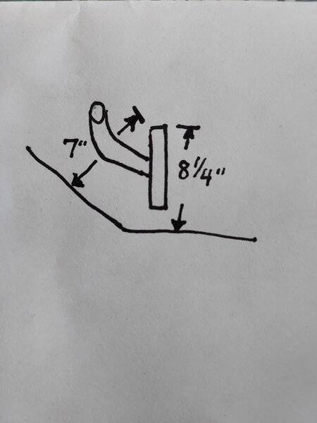

I can tell you for manual brakes when I get home in a few hours
I went through a lot of cussing converting the manual drum brakes to front disks and power brakes. Part of my issue is my kit wasn't exactly for my '63 - no bell crank since I didn't have power brakes. There are two holes in the brake pedal arm. One is for power and the other for manual 'pedal ratio' this is viewed in the FSM. I ended up keeping my power set up on the manual brake hole...a very long story on this; but it worked out fine. My pedal height is maybe around a 1/4" higher than it was, not enough for me to notice. My pedal height to the top of the pedal to the floor is at 7" little estimation since I'm pushing the tape measure into the carpeting having insulation and dynomax beneath...
1962 Dodge non power...
