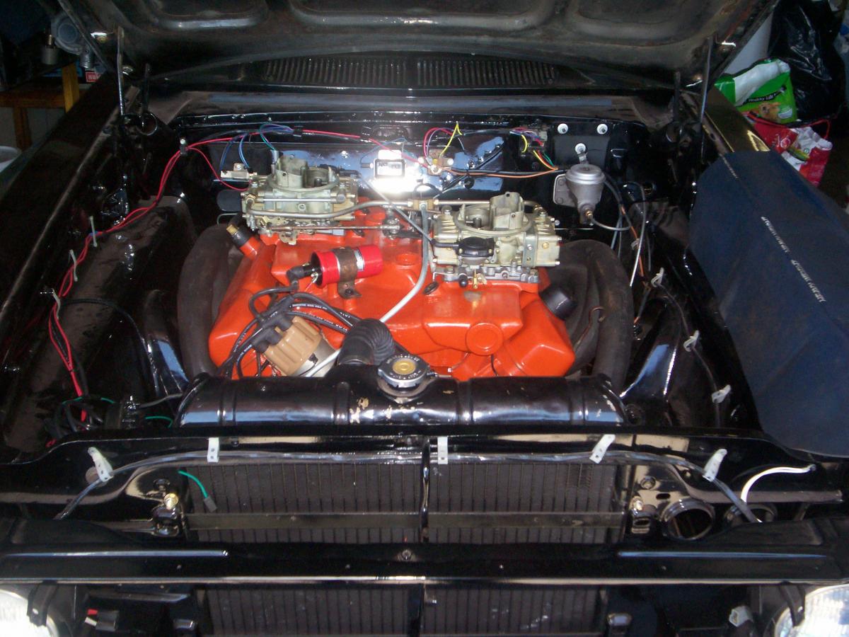

Im running a 4 core rad from a 62 cryslr 300 big block, 4-blade fan and a 180 thermo. i have a gauge and a stock gauge when the stock needle gets to about 3/4 way its about 190 on the gauge and it opens drops to about 180 and the stocky goes to the middle. im running a 500 stroker.
