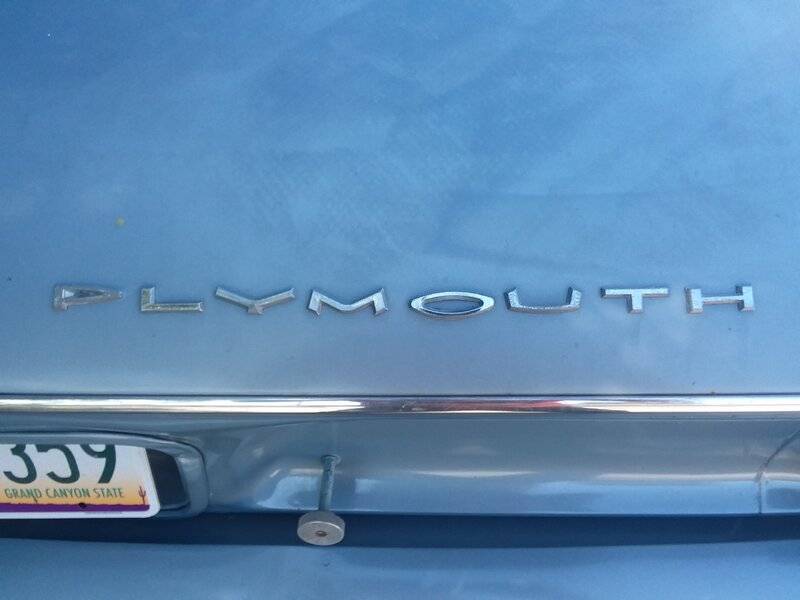

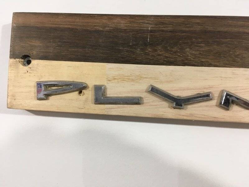

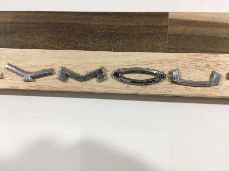

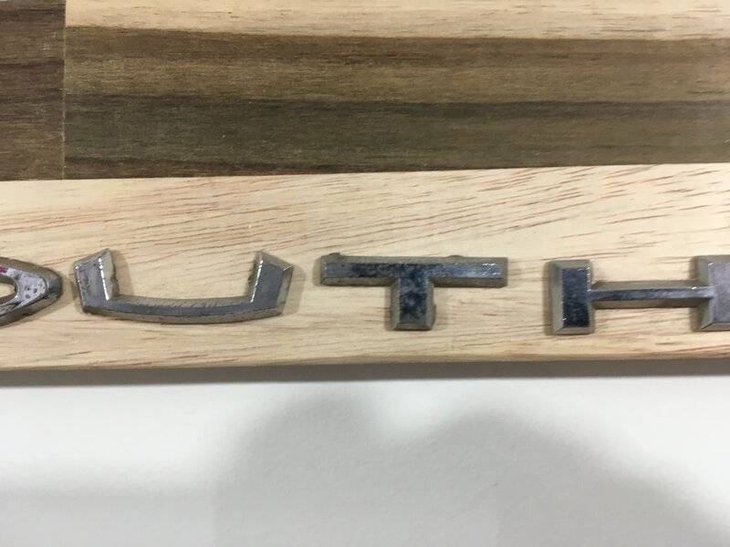

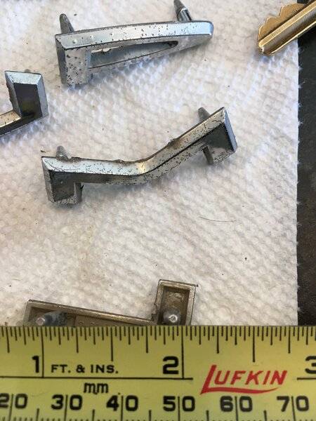

Not sure but, I read somewhere that the 63 letters are different. I have a set of 62s if you want

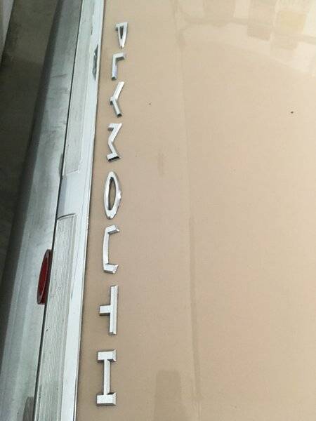

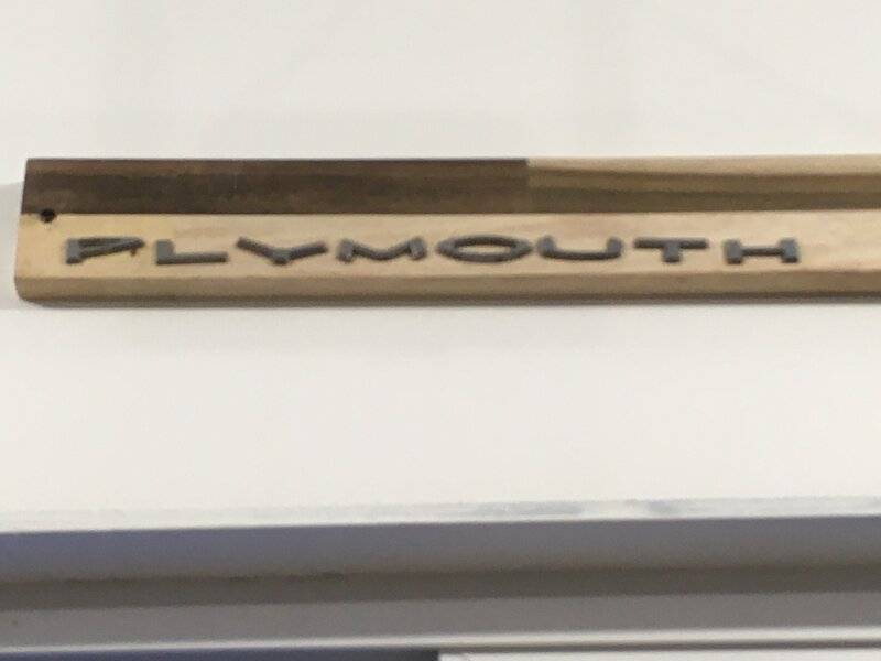

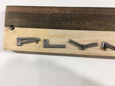

These are the letters on my 62 savoy.
Thanks guys, l have 2 sets l bought off ebay a few years back, now l think they are for a 65
Derv, pm sent

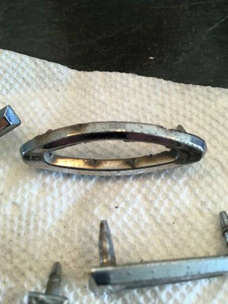

I've measured them exactly from a rubbing and punched holes in paper. Post to post measurements are P= 1 1/8" L= 7/8" Y= 1 5/16" M= 1 1/2" O= 1 5/16" U = 1 3/16" T= 15/16" H = 1 1/8"
