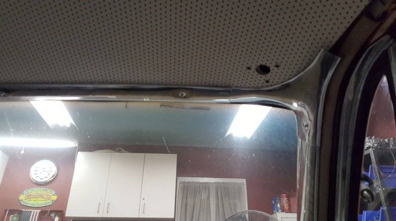

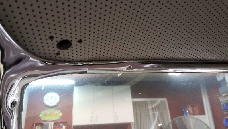

Hello,
I just ordered a set of visors from Classic Industries along with the "plastic sun visor tips". Once inserted into the visor and the other end snapped into the rear view mirror housing, is that the ONLY thing holding these visors in place? I tried to find pics but nope.

Don't you think the 3 screws at the pivot contribute to retention?

I should have explained more in depth. The original wooden headliner in my 62 shows no previous triangular mounting holes so, that's why I asked. It had no visors when I bought it. The 3rd pic shows the Classic Industries visors with no mounting accessories as opposed to my 70 Challenger visors (pic 4) and most every other Mopar. Plus if I do try to mount something like the triangular version, it will go thru the particle board and rip off the headliner since there are no "mounting plates" behind it and after that, is the roof. This is what I'm trying to figure out.

I just saw KHRYSLERKID'S link post of some great pics. I guess I gotta look behind that fiber board to see what's behind there to fasten the triangular mount to. I was "assuming" it was the fiber board then the metal roof.
