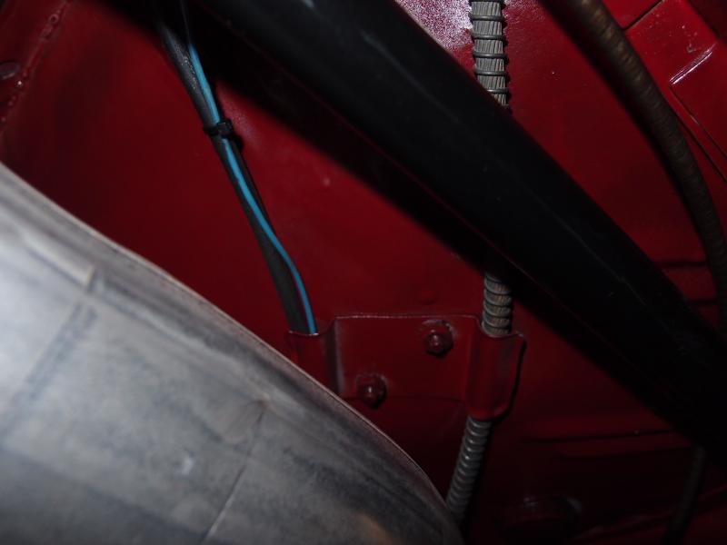

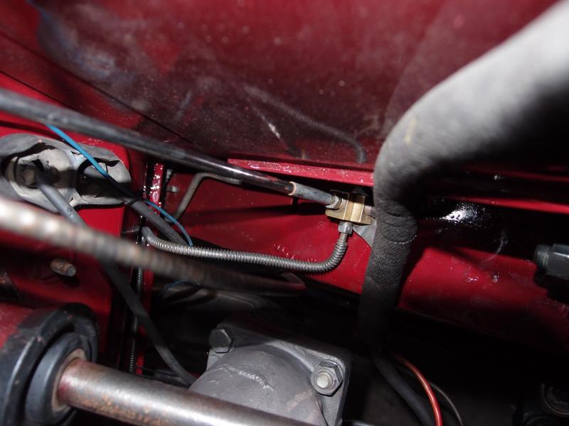

On mine, the park cable runs on top or over the exhaust. The shifter cable runs under and in front of the down pipe. The speedometer cable runs along the frame, not with the park cable. (Best pic I could get)

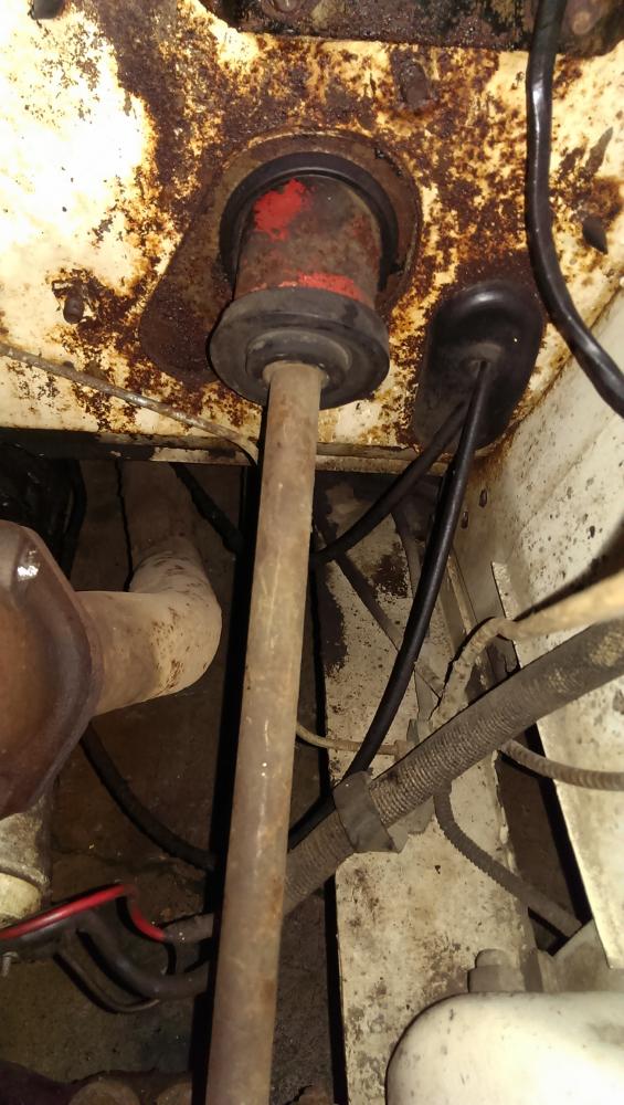

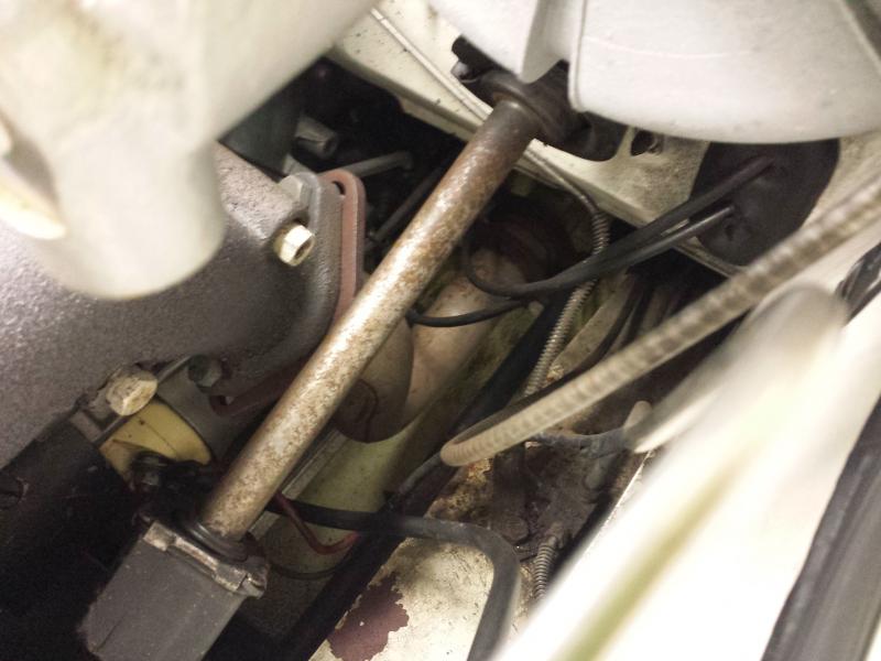

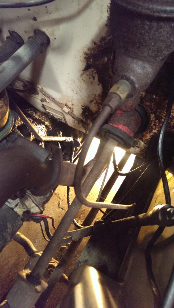

Wish I had a better pic but you can see the two that come through the grommet together have a plastic shield or coating. Shifter cable going to the front of the trans, park going just behind. The speedometer cable dosent have any plastic coating and goes along the frame before heading to the rear of tranny.This car is unmolested for the exception of the starter and alternator. Top pic shows speed cable.
Looks like a different length cable to me...
I accept your apology, lol
Doh, you're spot on KK, sorry about that. I forgot trans has 2 cables, one for gear shift and one for park sprag.
No doubting your shift cable is longer.
I'd say yours is more correct as I can't verify the origins of my trans and cables - it is a 300H engine (and perhaps trans as well?).
