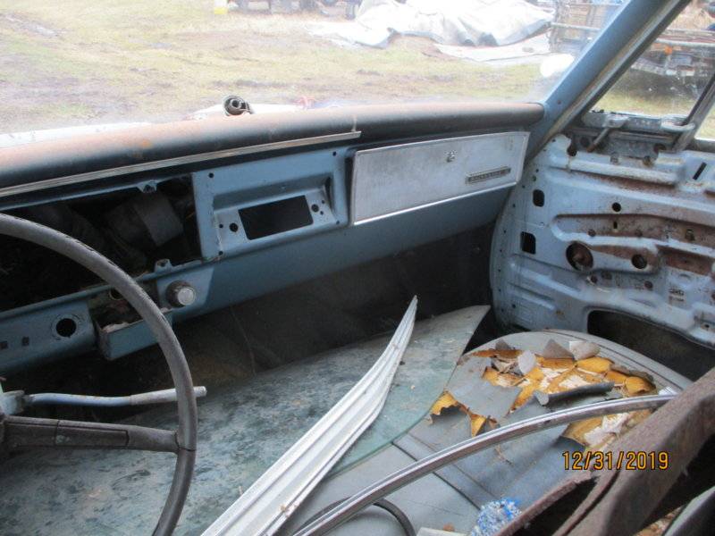

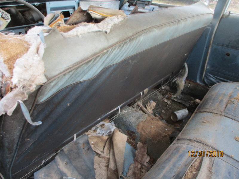

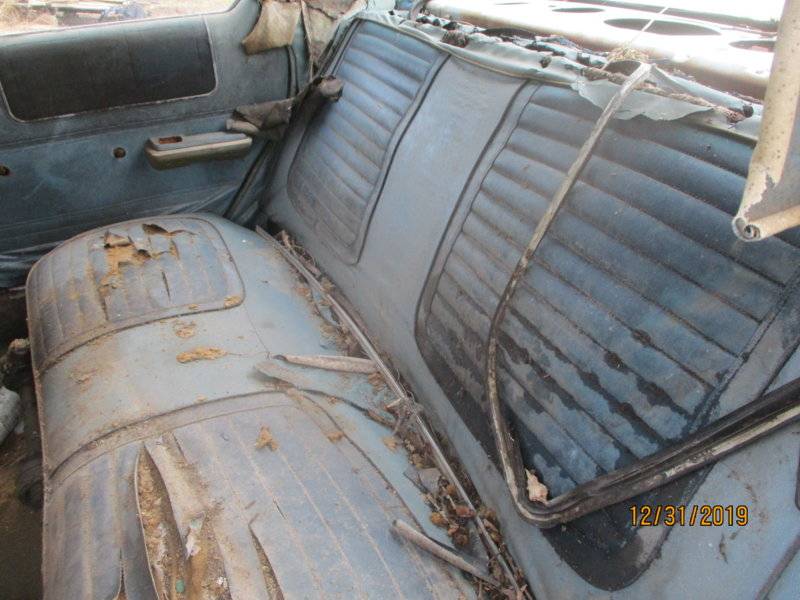

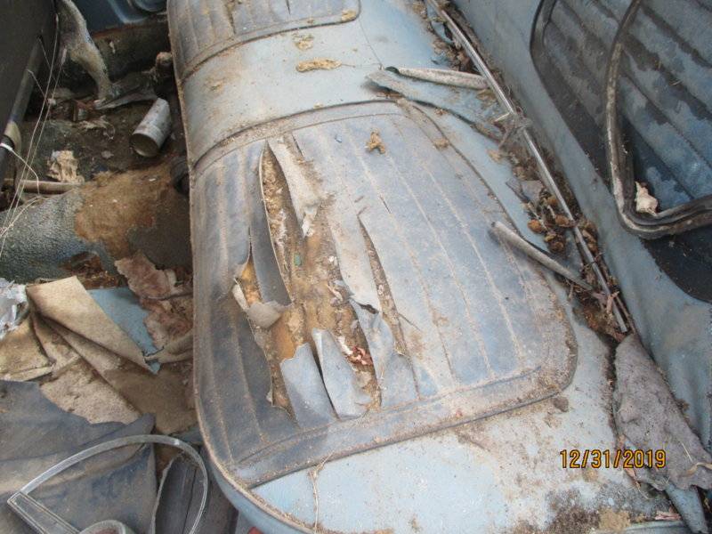

Here is whats in my 65 ply Belvedere II 4 door car that I want to try to use in either the 63 Belvedere or the 64 Fury 2 door hardtop. Anything factory correct for a swap?
View attachment 888661 View attachment 888662
Like others have said. The four door seat bottom is different than a two door, so it wouldn't be correct for a two door if its out of a four door.
