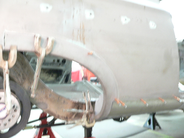

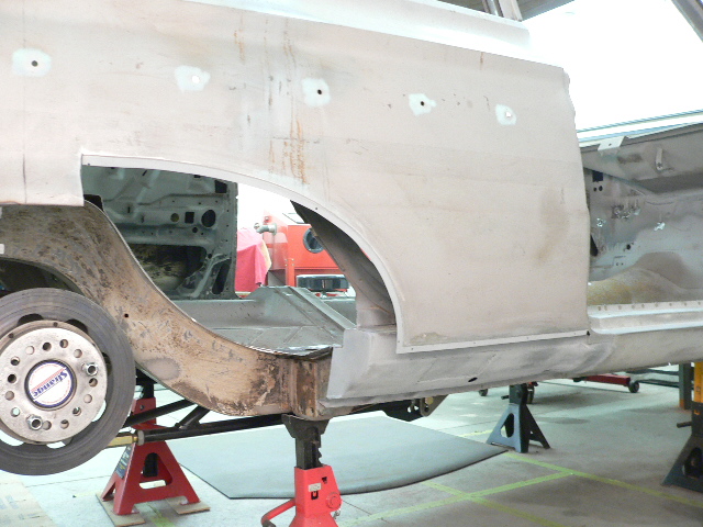

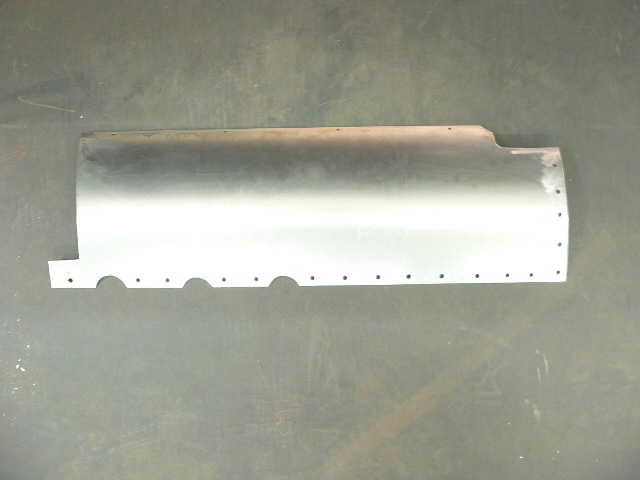

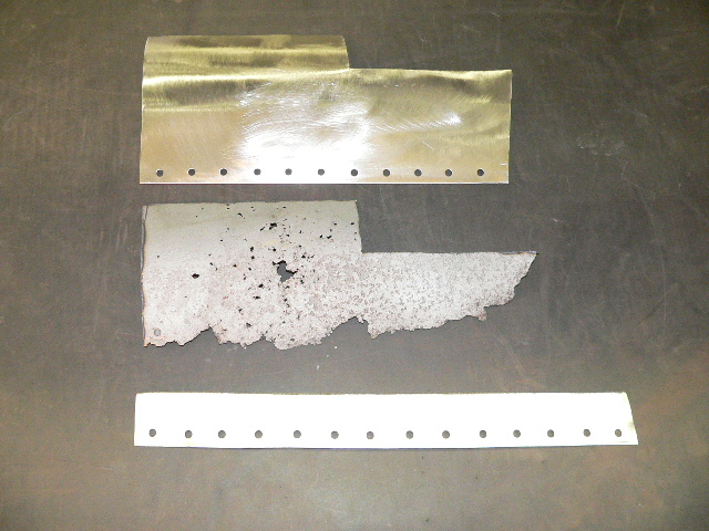

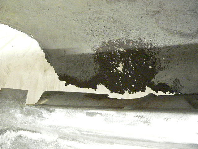

Patch Panels
I made my own. I had never done this before but it wasn't that hard. Cut it out, fab a part,weld it in. I formed te pieces over 2x4,pcv,hammer.
Doug

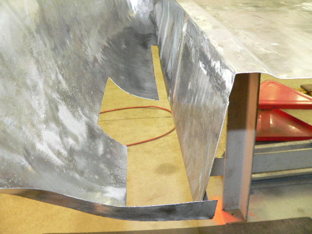

Here's the rest of the rear patches.
Doug
