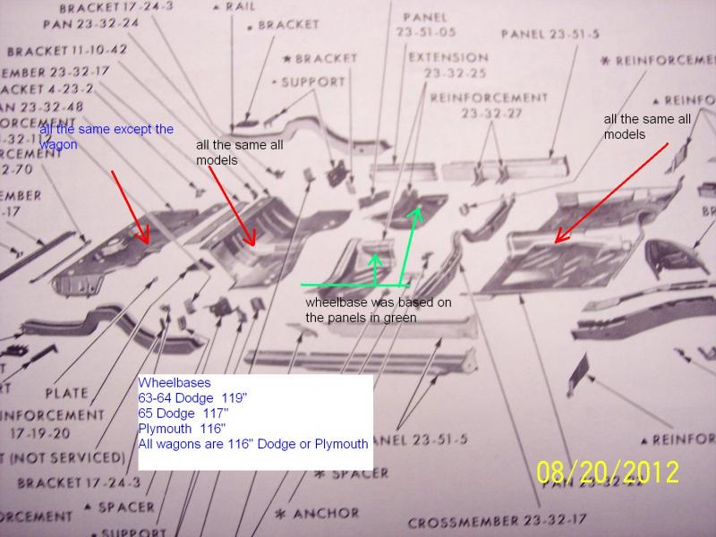

Joe
I checked the parts books for the information.
The green in the picture is where the wheelbase is lengthed
for the Dodge sdns.
Jeff
As stated above the difference in wheelbase is in the rear footwell pan. Same holds true in the difference between 63/4 Dodge and the others.
Sooo yes the front pan and under rear seat pans are the same. Use rear footwell pans for 62-5 Plymouth and 62 and 65 Dodge.
Don't know anyone making the under rear seat pan or the wagon only trunk pan.
I am getting a 62 wagon in a couple months to cut up. Hoping it has a nice rear pan.
Also 62B has the same pans and Dodge is a 117" wb.
Only the 63/4 Dodges having the 119" wb have the longer rear footwell pans.
Difference in 116" and 117" wb is in the spring hangers.
