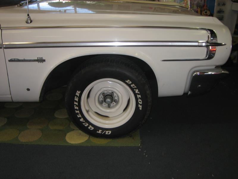

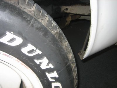

Here is my '64 Polara with 15"x7" stock steel wheels. I had to trim the inside corner off the front of the fender wheel opening. The outer edge of the tire would rub the fender while turning. You can't even tell it's been trimmed.

7396272-2012-08-19_17-07-49_66(1280x722).jpg15x7 with 275/60x15 there's a ton of room. A 8" wheel would fit easily. Measure off set from the drum face to the leaf spring and then to fender lip. Offset will differ on whether it has the stock axle housing. 225/70x15 works well on the front. Here is my sons 62 sleeper (10.08@136).
