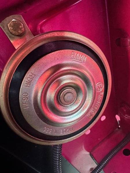

i never use my horn. Recently I honked it and it sounded quite wimpy. Here's picture of it, what should a 63 OEM horn look like?

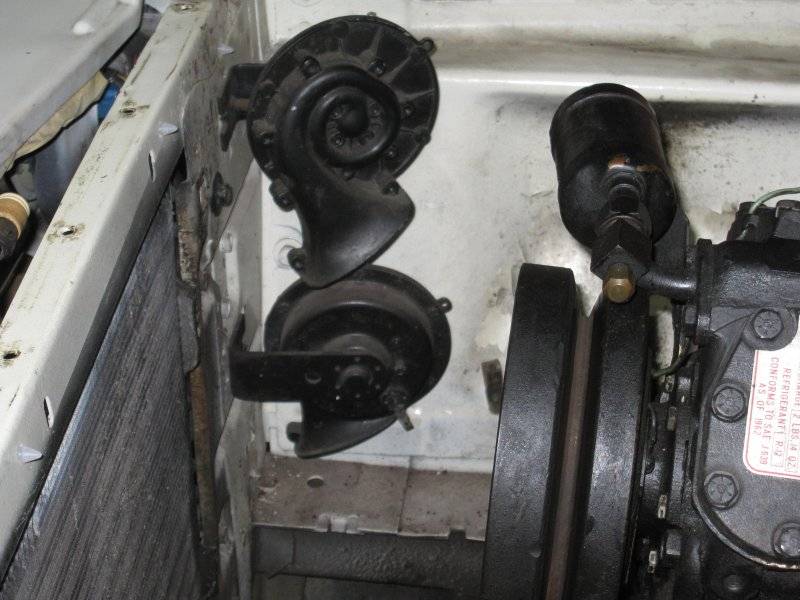

Not original. They have dual horns, a HIGH and LOW horn set-up. Here are the ones I have on a 63 Polara...
I can't say this is correct for a 62 but, this is my original 65 horn layout.

Yep those are it. I bought a set and one did not work.
Do a bench test and turn the adjustment screw .... it may start working .Mine did and they are LOUD
After posting this I educated myself on the topic. The green wire is present and there are two connectors, one isn't being used at present. I'll buy a pair of more appropriate horns eventually.
