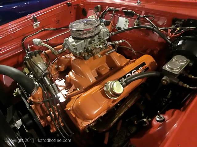

I want to do a single to dual master cylinder swap. Thoughts on what to use and weather power is required.
Any later model (68 and up) should work just fine. Power is not needed unless you want it. Might have to bend up a couple new lines.
I used this stock master cylinder from a 68 B-body. Bolted right up to my brake booster. Then I just changed the lines to work as I went to the T-valve and unhooked the line to the rear and hooked it to one side of the M/C. Then pluged the hole where I unhooked the line to the rear and then hooked the other line that was at the old M/C to the other side of the dual M/C. Ron
I was going almost 130mph in the 1/4 before I installed a 1967 dual for manual drum brakes:blob1:
I did my 63 used 69 b body master with stock push rod and metering block from a 68 fury bob
