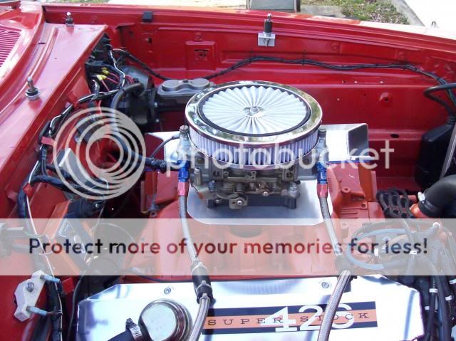

I know putting a 66 to 70 K-frame in a 63 moves the eng back about 2 inches which will help getting weight over the rear wheels. But I will say I still use the stock K-frame as you can see how much room it gives you at the rear of the eng. And I have had no traction problems hooking up with my 63 as most of the time at any track it hooks good. I also like the extra room it gives you at the back of the eng. And be aware if you plan to run the crossram the 66 to 70 K-frame moves the eng back enough that you may have to bang a little dent in the firewall as I believe the 66 to 70 K-frame can cause the crossram intake to hit the firewall. Ron
