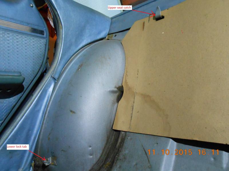

Here are a couple pictures that may help.
Jeff

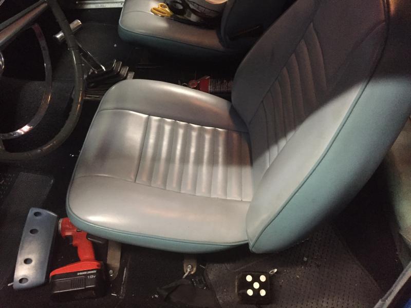

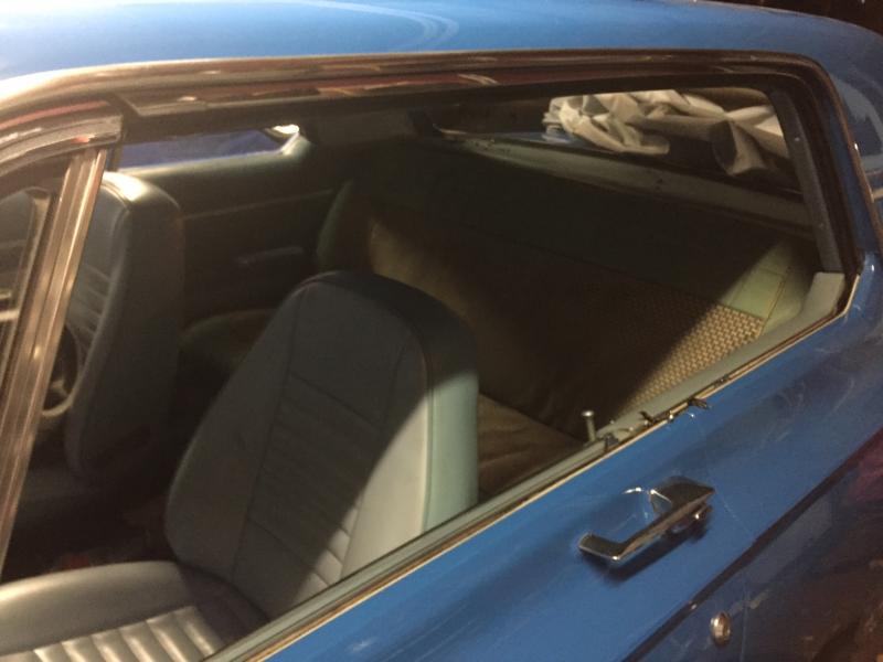

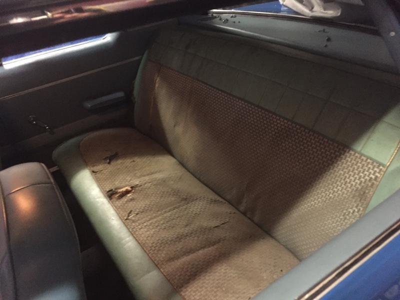

thanks for the replys. Now I have another question Im trying to get the rear seat recovered and the cheapest I got quoted was 1000CAD which seems like alot is there an off the shelf cover that I COULD GET TO MATCH THE FRONT and are the front oem if not ??IMG_0364.jpgIMG_0365.jpgIMG_0366.jpg

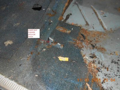

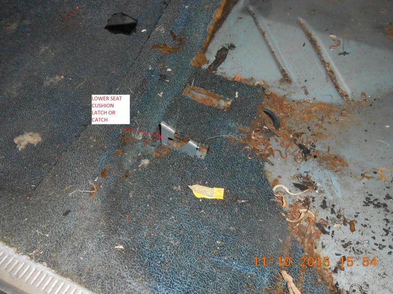

does anyone have any ideas how I could attach the seats with out those clips ?
Can you see where they were before someone removed them? If so, get a set of brackets from one of the Mopar wrecking yards and weld or bolt them in:
