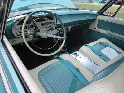

That is definitely a huge help!!! Thank you for the pictures! Now I know what I need to find...that dash emblem is most likely all but IMPOSSIBLE to find.
This may help you also...
holy crap that blue interior is identical to mine! WOW those colors sure do pop! unfortunately the interior in my polara looks much much much worse than that in yours. I too went with black carpet, but my seats, dash, and door panels are all totally F*&$ed up. Do you mind if I ask who did the door panels for you? I wish I could mount my tach down where yours is but I have a pistol grip 4 speed in mine so that makes it a no-go. What a great looking interior...I am so super jealous right now!
Also, I just noticed...I have my seatbelts bolted up basically reverse of what you have. Mine arent original to the car as they came out of my 66 chrysler, but they are the same blue color. I mounted mine as I took them out of the 66 Chrysler Newport meaning the short side with the "male" end is on the outside and the long "female side" is on the inside. The ones I took out of the Chrysler have a large plastic housing with a spring loaded mechanism on the short side and I am guessing that is not correct on a 63?
Ya, me too...that a photo of a friends interior.....LMAO!!!!!
