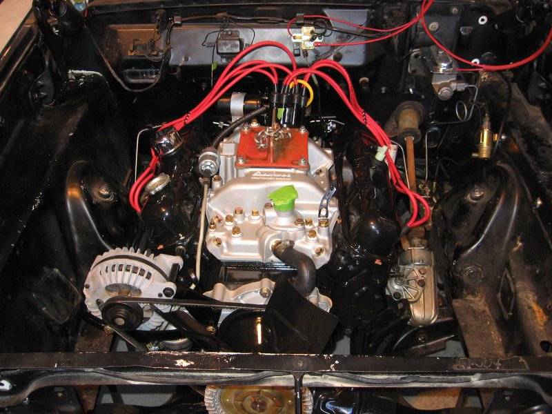

My car still had line lock from it's drag car days in this photo.
You can see the distribution block and the lines for front and rear.

The distribution block Fran showed is a better choice.
If you plumb the lines directly front and back and lose the front pressure you only have back brakes which lock right up at highway speeds and hardly slow you at all.
