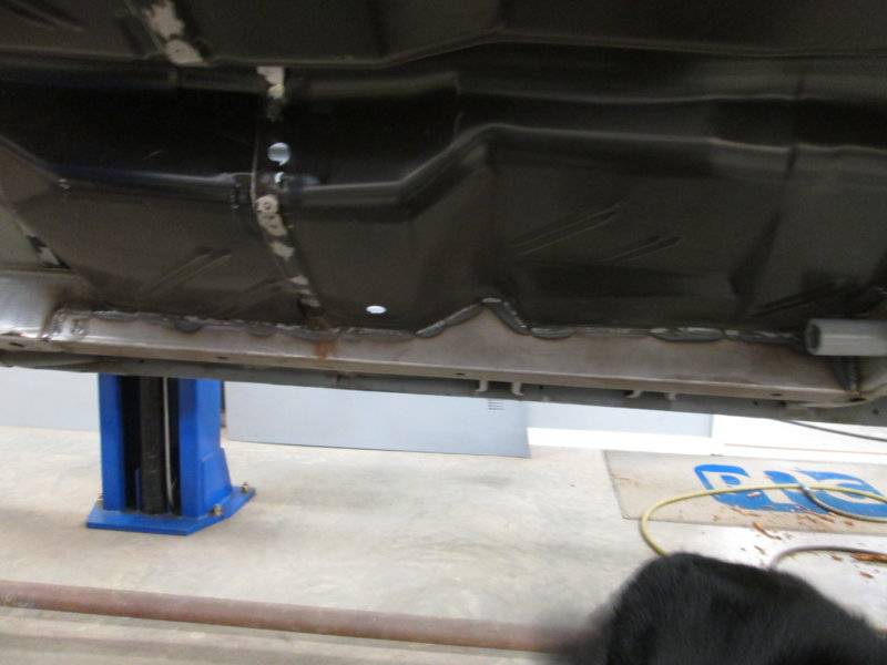

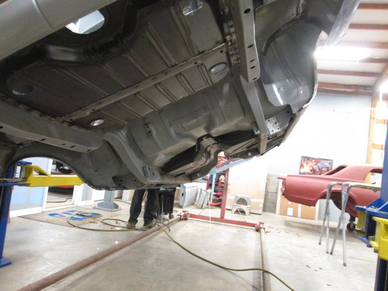

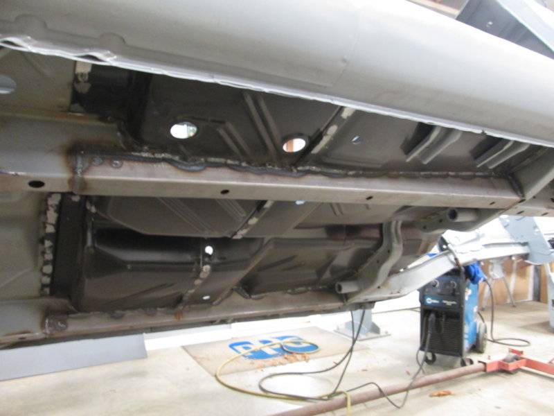

Here's the US Car Tool Frame Conns on my '63 330. They went in very nicely, and look pretty good too. You could easily go with the US CT Level 1 Kit, as you won't need anything more with 400 HP...
Don't need frames tied at that HP level.

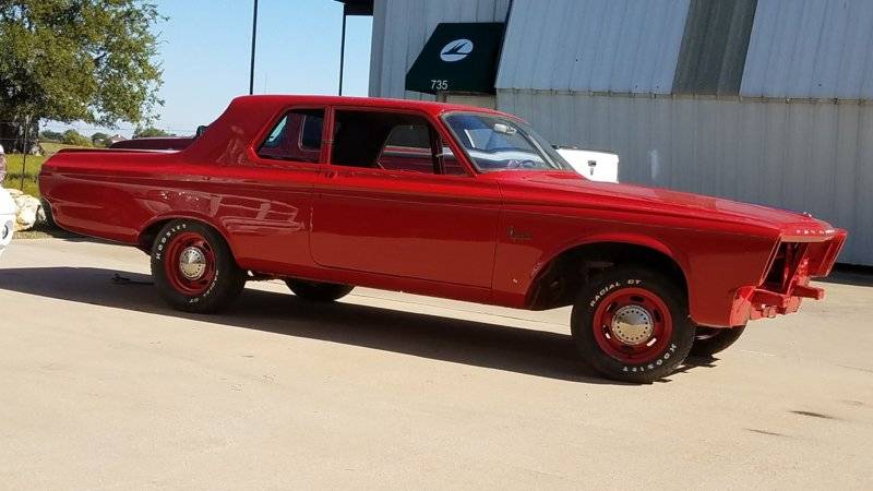

Those wheels and tires... ugh... it's like drawing a mustache on the Mona Lisa
Why do you feel it's necessary to make a remark like that? I don't see where the OP asked for your opinion...Do you think anybody really cares what you think about those wheels and tires?
Nice looking 63. One of my favorites. I had good luck with non-power Wilwoods at all 4 corners. Simple and no caliper slides to corrode and stick. Very easy pad replacement. Sub-frame connectors a good idea if for no other reason than to just keep the uni-body from settling in the center on these old bodies.
Nice work as that looks great. Good luck with it !!! Ron
