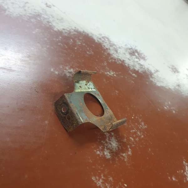

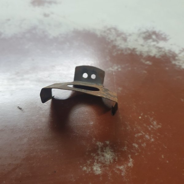

Hi fbbo,

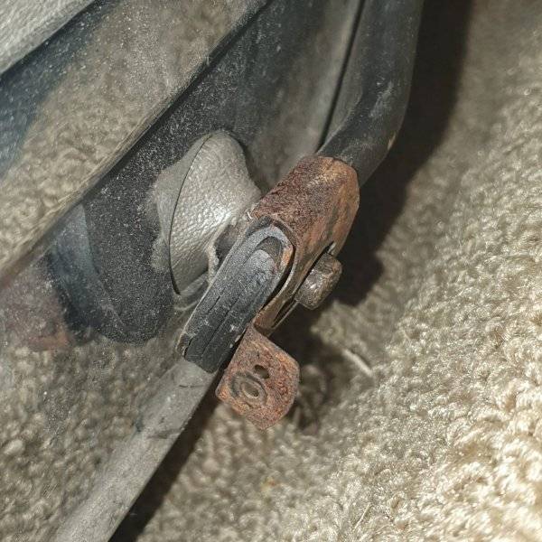

I need this part for my 64 polara. It is missing one one side of the bench. I bought new hinge covers and can not tighten them properly.
I have welded a small tab on the front of the seat hinge iron to take the place of that part . Drill a hole and use a screw just like that part is used for
