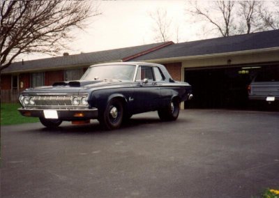

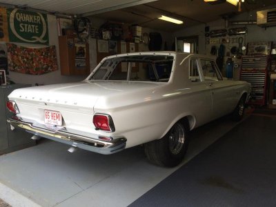

b bodydodge; some years back I had pro trac street tires on my 64. They measured apox 31" tall and were 14" side wall to sidewall on a 10" wheel w/ 7" back space 3" front. Part # was s375. Coker now makes them. This pic is those tires. If you look at page 32 in the 62-65 car show thread I posted pics w/ M/T street ET's that are 31x14.50x15 on same wheel. The pro Tracts were a snug fit but never any issues. The M/Ts are a more comfortable fit. Hope this helps.
I have the same mods as you. Tom
65HEMI; Beautiful!

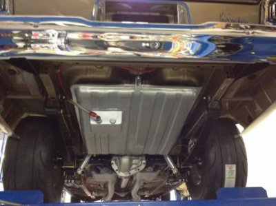

315/60/15 on a 10" rim. Mini tubbed and springs relocated. Loads of room on both sides of the tires.image.jpg
