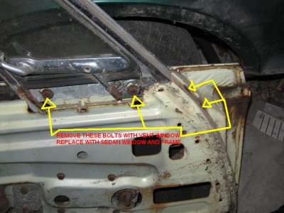

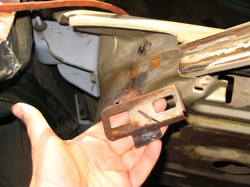

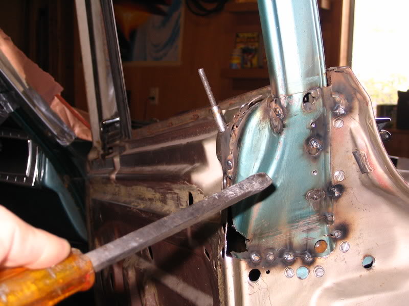

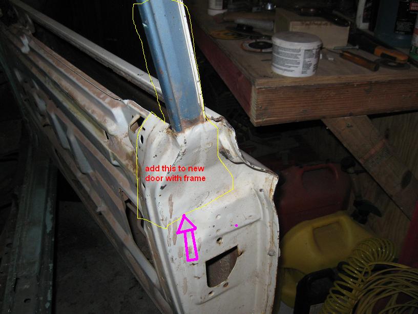

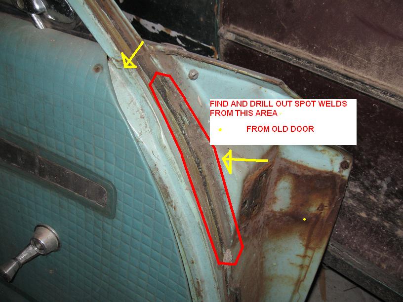

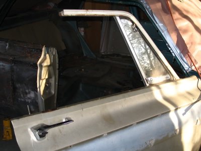

go to the 1962to1965 mopar site a guy did it on there . you to drill out the spot welds and use the glass and vent window off the sedan doors it can be done
yes it can be done my friend did it on his 65 awb project and it looks like it came that way.
doors

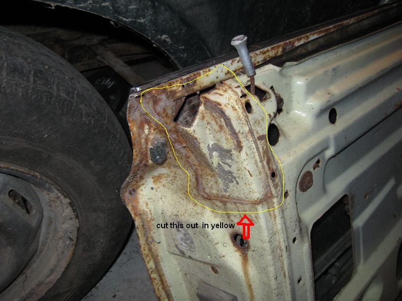

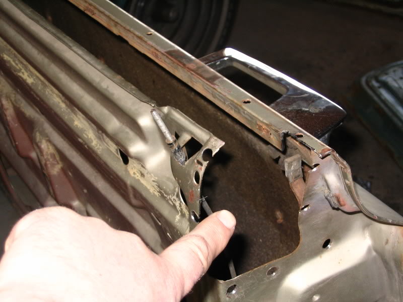

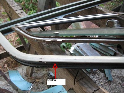

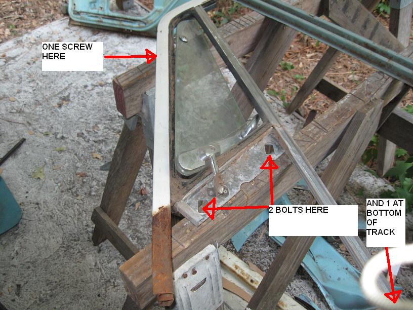

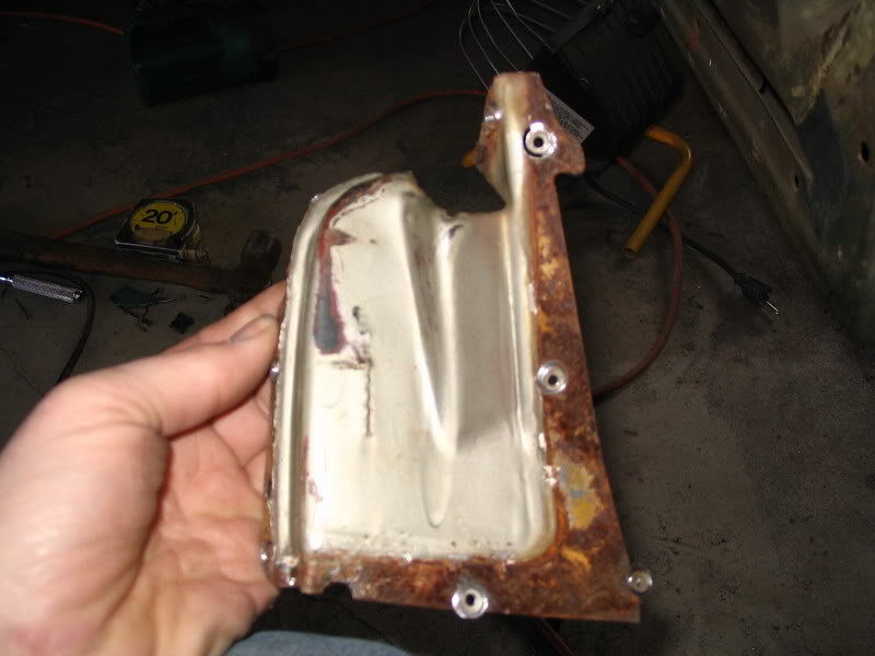

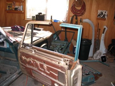

heres a few pics on the subject
found these on the 62 to 65 web site
hope this helps

Nice tutorial. We did it on our AWB as well when we did the 2dr conversion. Tack everything in place with the doors hanging on the car so you know everything will line up the way it should, then weld it solid. It's not a huge undertaking. Good luck.
