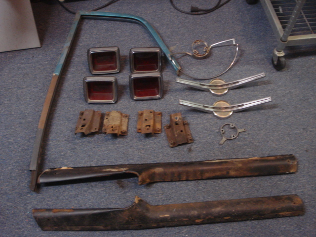

Hi Guys,
Hope someone can help I'm looking for a passenger rear qtr window inner frame the one shown in the photo is for the drivers side. Thanks
Get a rear door for the side you need from any 63-5 Dodge or Plymouth 4-dr sedan and use the window framework from it. You will need to cut it down and weld it, but you have the other side for a perfect guide. I just took apart a 64 Ply. 2-dr sedan and compared the parts and it should work very easily.
